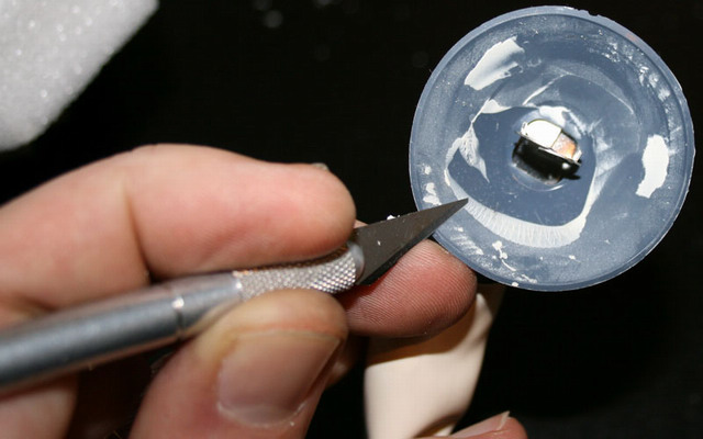

10. While still being careful to NOT move the glass tube itself from the LC housing, cut the circular outer edge of the HV silicon cup with a sharp cutter/blade. Then, using a small flat screwdriver, gently pry up the cup from the white silicon. Do it VERY slowly so that most of the white silicon remains on the glass:

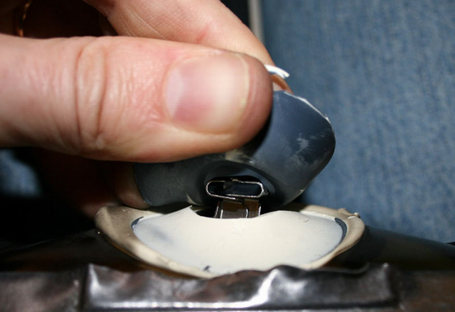

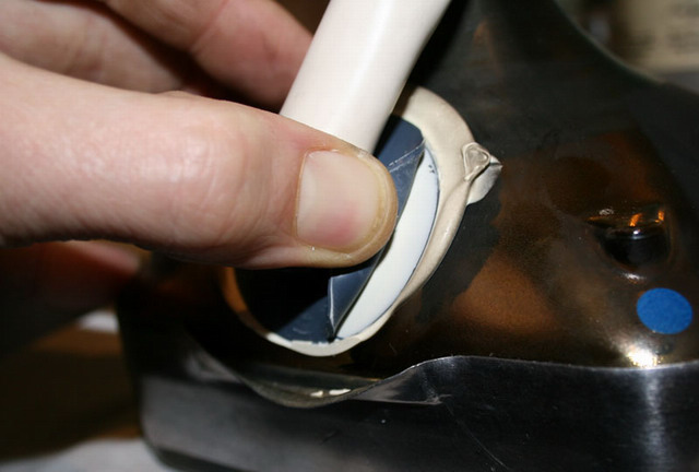

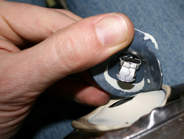

11. Continue to SLOWLY pry up the cup all around the center hole:

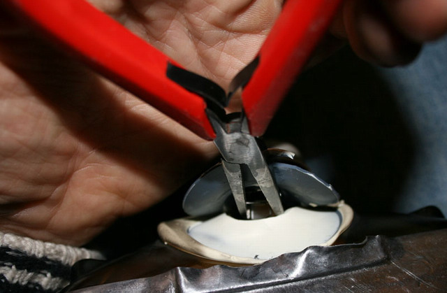

12. Using a pair of needle nose pliers, squeeze the metal leads together in order to remove the HV cup from the  hole:

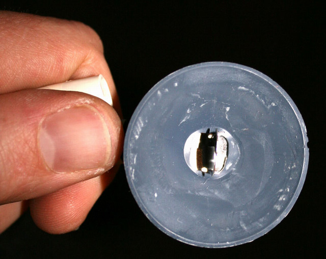

14. The inside must be clean and look like this when you're done:
