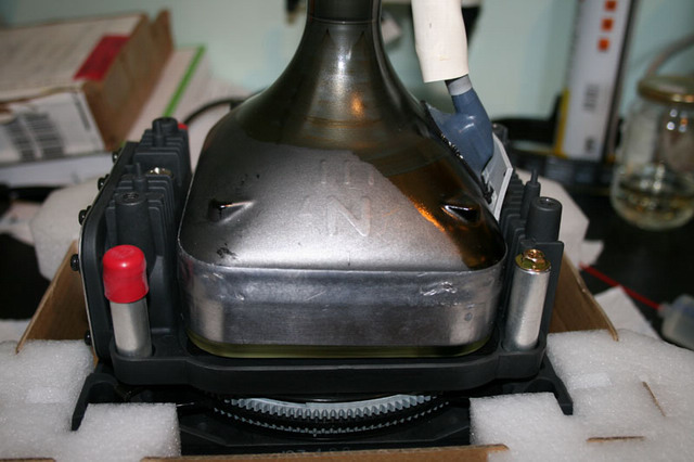

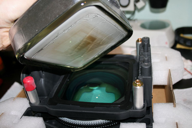

18. After waiting 7 days, prepare the new tube with the old one still on its LC housing close by. With your left hand gently tilt the old tube neck so the tube face gets removed from the LC housing joint:
No glycol should spit/splash. Remove the toasted tube from the LC housing in a fast movement so no dust can enter glycol chamber housing:
19. Immediately place the new tube on the LC housing joint. Take extra care to get the tube’s orientation right! Center the tube on the joint by looking at the tube neck end against the LC housing edges:

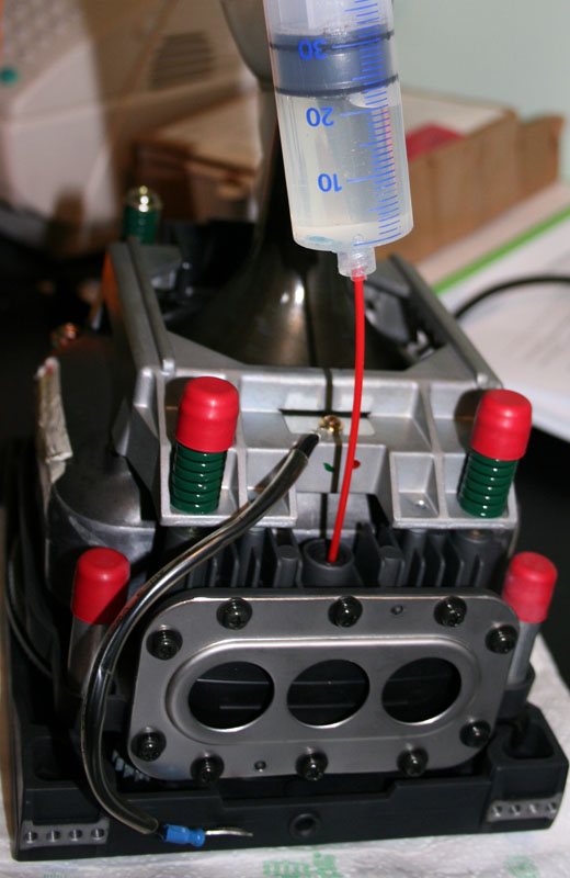

21. Using the syringe, put the 150-200ml glycol back in the tank. At each 50ml step, gently tilt the tube to let the air bubbles exit the C-element chamber via the tank’s hole (this allows you to continue to fill the tank with glycol).
