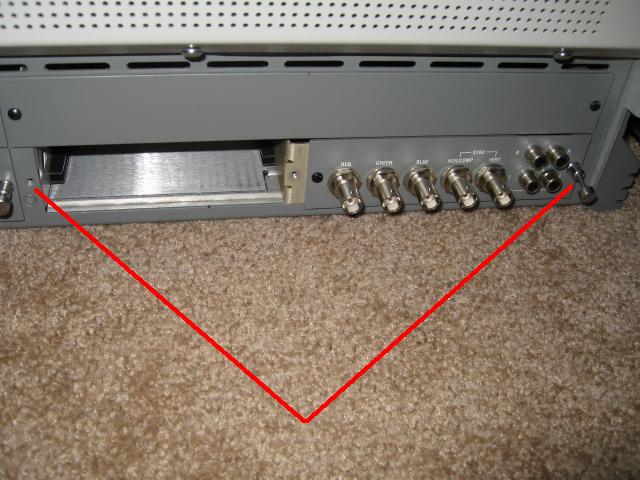

Step 6: VIM
Undo the tiny black screw on the left side and the thumbscrew on the right. Your Marquee may have thumbscrews on both sides... it just depends on what add-in module your Marquee has. The add-in module was already removed from this VIM. If you have an add-in module, you must remove it before removing the VIM.
Now that it's unscrewed, GENTLY pull the VIM only HALF WAY out of the Marquee. This is VERY important, as you will encounter three video cables holding it back. We don't want to stress those cables.

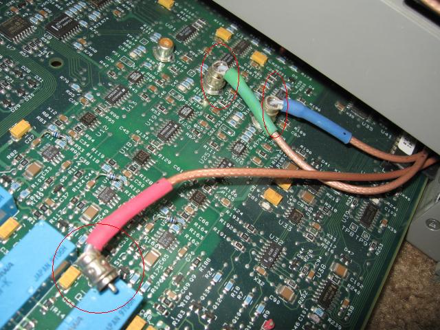

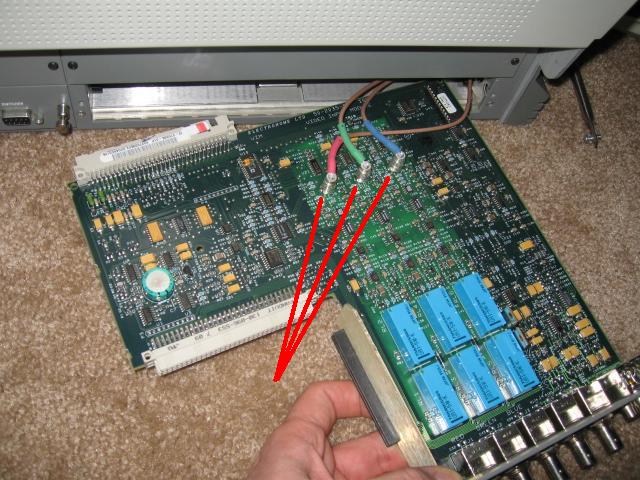

Now, you will see three mini-RCA's plugged into the VIM. You will remove these by gently wiggling them left & right, while you pull upwards. Try to pull on the plug itself, and not the wire.
Now that you have removed each of the three mini-RCA's from the VIM, go ahead and remove the VIM from the Marquee.
