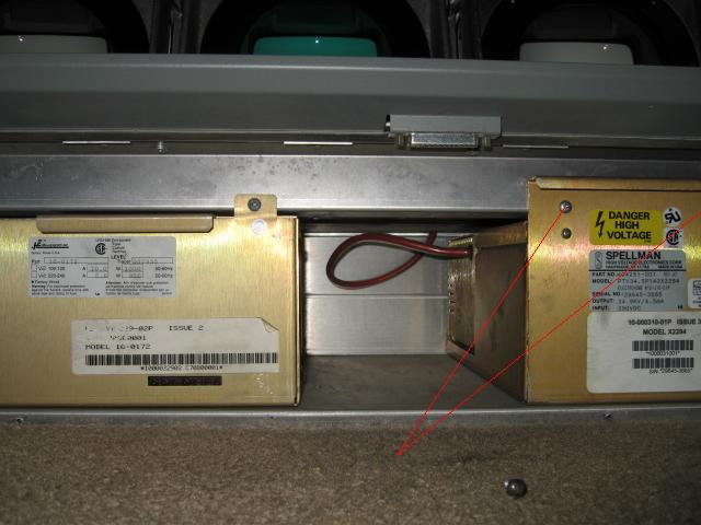

Okay, now remove the two screws pictured below (one is cut out of the view, but you will see it).

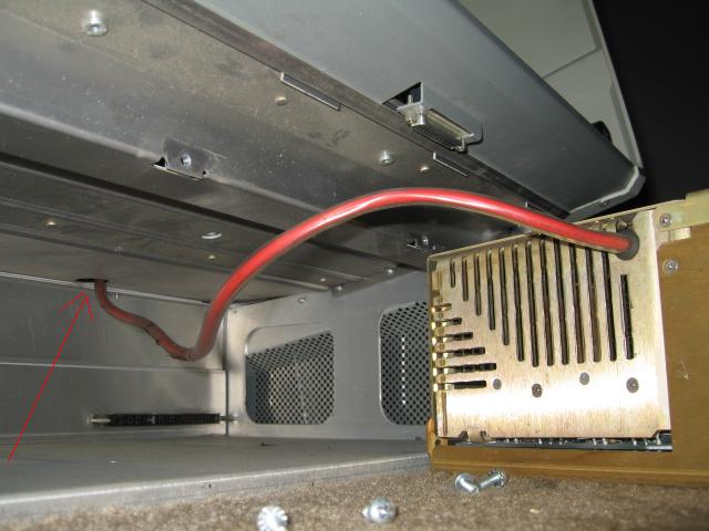

Now, pull the HVPS about halfway out of the Marquee.
See how the HV cable comes out of the HVPS and goes up into the chassis?

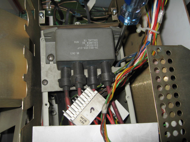

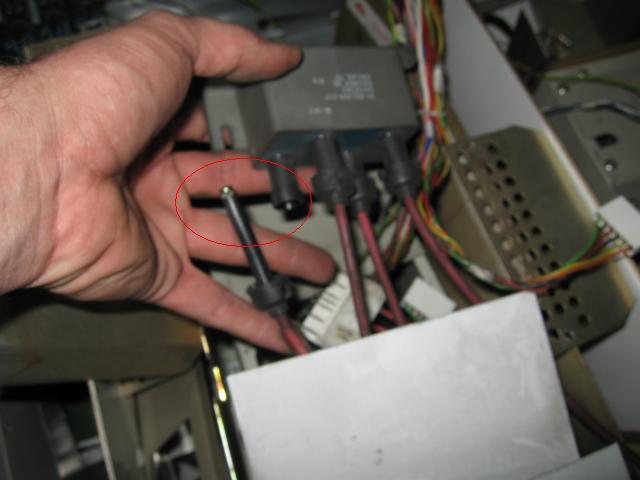

Okay, well lets go back up top and remove the HV cable by pressing it inwards, then turning it counter-clockwise to unlock it from the splitter (grey box). Then pull it out, so it looks like the picture below.

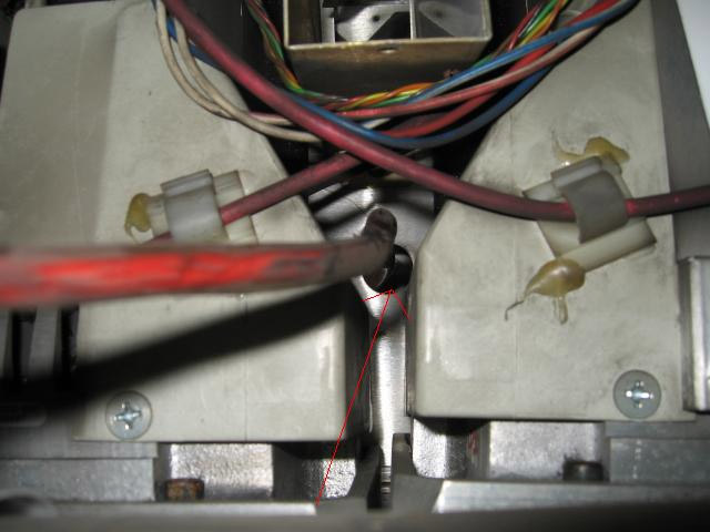

Now, trace the HV line to where it goes down into the chassis and through the pictured hole. With one hand, reach under the chassis and pull the cable down. Use your other hand to help guide the HV cable from the top.

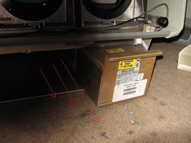

Now that you have the cable removed from the chassis, go ahead and completely remove the HVPS.
