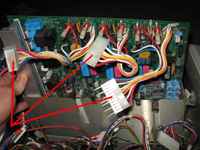

The HDM board is the one shown on the right.

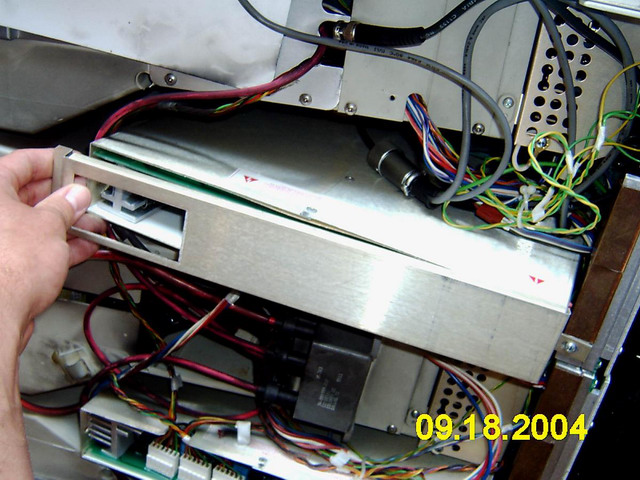

Again, remove the little top cover by pulling up at the front.
Now, disconnect the three connectors shown. This is a picture of them after they were already disconnected. It's important to keep the metal prongs, with the board's connectors. In this picture, you see two connectors without the metal prongs. Now I gotta go find them and put them back on! :)

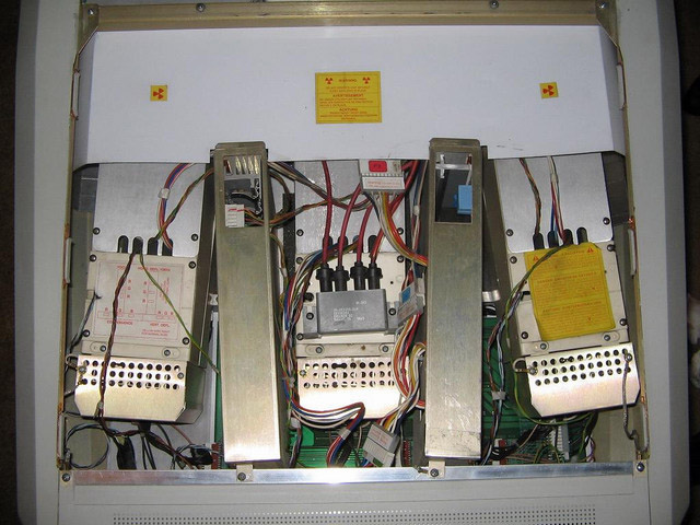

Now pull up on the board by pulling at it's edges, not the electronics. Remove it from the Marquee. The below picture shows what the Marquee will look like with it's Focus and HDM boards removed.
