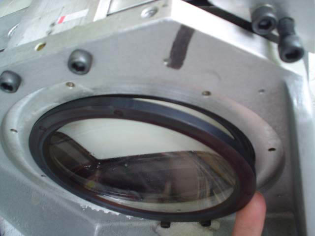

10. With your fingers pull on the edge of the lens. The black edge is small, but you should be able to gently pull on it. Work you fingers around the entire edge and find a loose edge. Once you have a loose edge, slowly pull the lens.
11. You may need to use a screwdriver to help the lens free. BE CAREFUL, not to tear the bellows, as this would require a complete LC Assembly strip down and bellow replacement.
