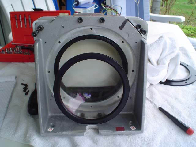

13. You now need to wash your hands so you have no glycol on your hands.
14. On the New Red C-element you smear a very light coating of RTV Silicon, this will seal the C-element in place. Don’t use too much as it will become very messy.
15. Don’t touch the Red part of the C-element with your fingers.
16. Place the Red C-element into place and gently push.
17. Replace the Black Face Ring and install the 4x Hex Bolts.
18. Visually check all looks good.
19. Let the C-element sit for a week to cure.
20. Now you are ready to refill with NEW Glycol. Glycol turns yellow over time, so it would probably be a good thing to replace the other 2 tubes glycol as well. You have a week to do it as the Red C-element is curing.
21. Leave a small air bubble in the top of the LC chamber, there is no reason to fill it right up.
I hope that this helps those see how to change the Red C-element.
