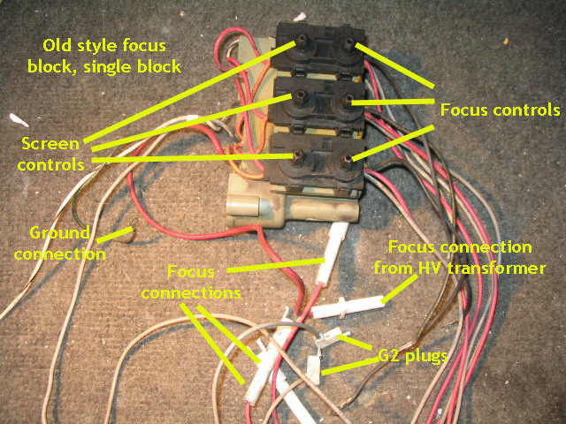

Let’s look at the original focus block:
The original focus block is a one piece unit, and is located in the right back
corner of the set as looking at the set floor mounted. The 3 focus and three
screen controls (master brightness) can be adjusted by removing the back cover
of the projector.
Let’s identify the wiring, partially shown above:
4- ground screws, terminated in round screw lugs. These can be bolted
anywhere to the metal chassis, Zenith usually puts two ground lugs under each
screw, located beside each other.
Three gray G2 wires with single pin connectors that go to each CRT video
board
Three red focus wires that connect to the red focus wire coming from each CRT
video board.
One long gray and black wire, ending in a 2 pin connector that plugs into the
bottom of the deflection board.
One gray or green wire that goes to the small focus modulation PC board next
to the focus block. (note that only the PRO 851 vintage of the chassis (post
1993) used this focus modulation wire, the older PRO 840’s did not have this
wire. The new style focus block may be used in the PRO 840 by simply leaving
this wire unconnected and taped up).
One red wire that connects to the focus wire coming from the HV board.
Four receptacles on the block that accept the main HV feed wire and the three
red HV wires going to each CRT.
