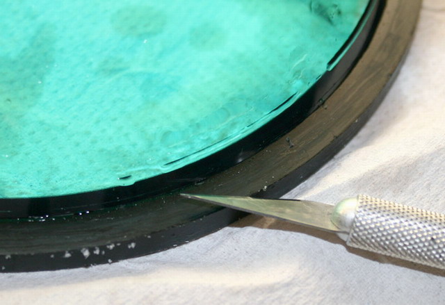

16. Finally, make the border of the C-Element as clean and flat as possible by removing any remaining rubber bits:
Ensure that the convex part of the new C-Element is completely clean of any dust or debris!

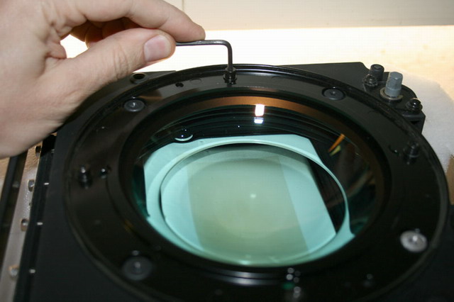

17. Back on the LC housing assembly... Remove the 4 screws from the annular (ring) bezel:

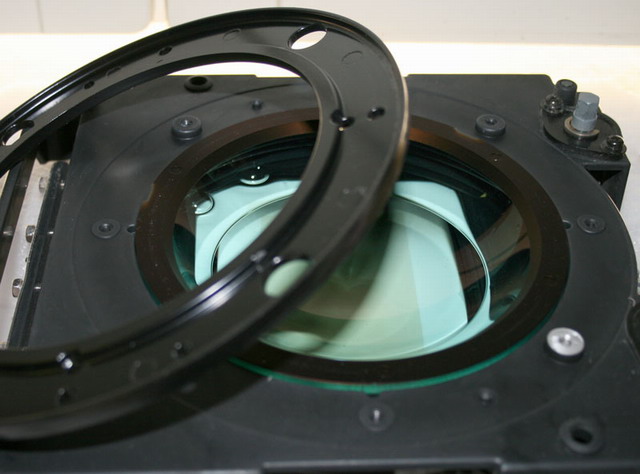

18. Remove the annular bezel:

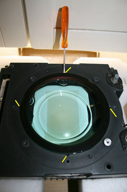

19. With a small flat screw driver, use the four small holes to pull-up the Sony C-Element from the LC housing (do it in circular manner). Take care of the annular rubber joint that may remain attached to the C-Element while you pull it out!:
