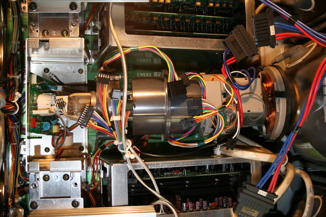

4. Disconnect all of the coil connectors, including the DY ground lead:

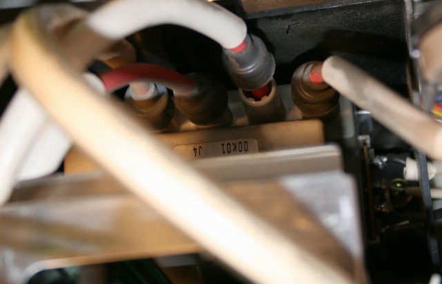

5. Locate and pull-up the green HV lead rubber cap from the HV splitter located between green and blue tubes:
6. Press down then rotate 90° the selected green HV lead wire to unplug it from splitter:

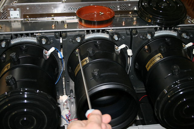

7. Remove the green lens by unscrewing the four screws (starting from bottom while holding lens with hand). Place it in a CLEAN area:
