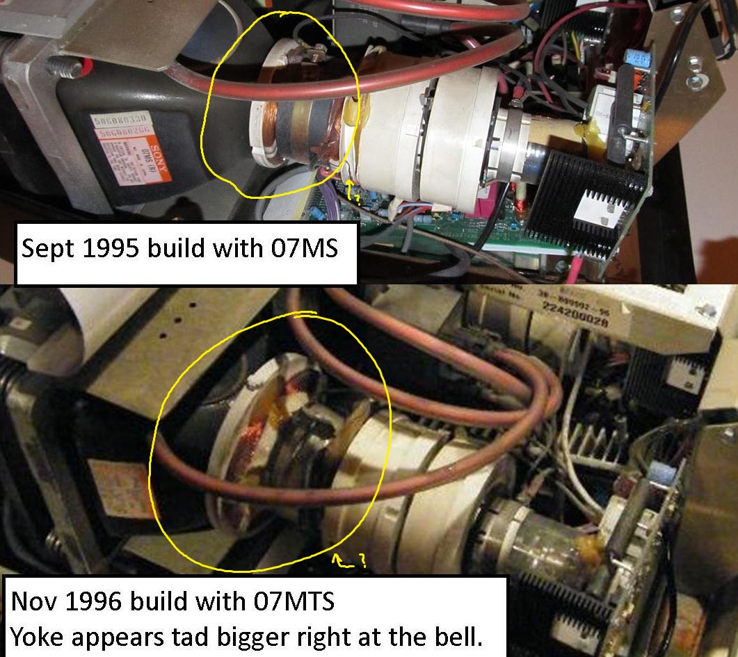

Minor clarification: the 07MTS marked tubes have P14 on them as well, but I don't think any 07MS (no "T") were badged that way. Maybe there is a reality that matters, maybe not, no idea. Going back to my original post, the AVS debate on magnetics on these might be settled with the attached image.
07MS magnetics vs 07MTS/P14 magnetics
