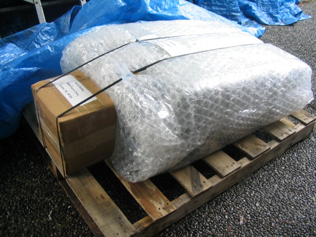

I wrap the projector in two layers of bubble wrap and strap it to a pallet. Using a pallet is key as it ensures that the shipping company will use a forklift to move the projector around and not try to do it with a dolly or (heaven forbid) by hand.  By forcing the shippers to always use a forklift you're ensuring that the projector will always stay upright and is less likely to be dropped/bumped/etc.
To ensure safe transit of projectors with heavier CRT sockets or thinner CRT necks (ex: Sony G70 and the NEC XG series) I take the lenses and/or CRT sockets and put them in a separate box. The bubble wrap protects the set from damage and I’ve had excellent success shipping in this manner.

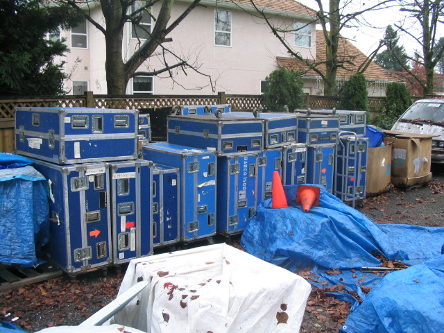

Sometimes I get in shipments of projectors in road cases (see image below), and I give these road cases away if I have one that fits the projector you buy. The cases are free, but the weight can add up to $100 to the cost of shipping, so keep that in mind if you want one. The cases do make great gear cases for bands and many other uses... :)

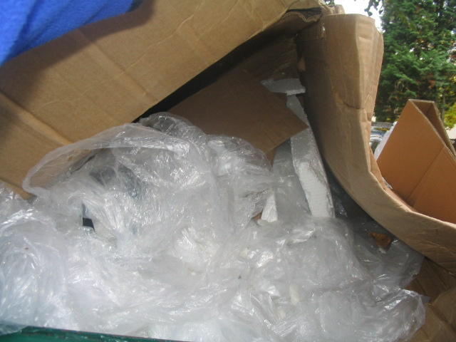

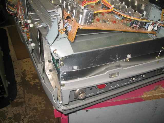

See the images below for what happened to one Sony 12XX series projector sent to me for repair. Packaged in bubble wrap and Styrofoam chips in a cardboard box and sent FedEx ground. The customer ended up buying a new set for obvious reasons! ‘Nuff said!
Here's what the shipping "box" looked like when it arrived at my door (box demolished, peanuts everywhere):
The projector that was inside was a write-off as it had been bounced end over end:
