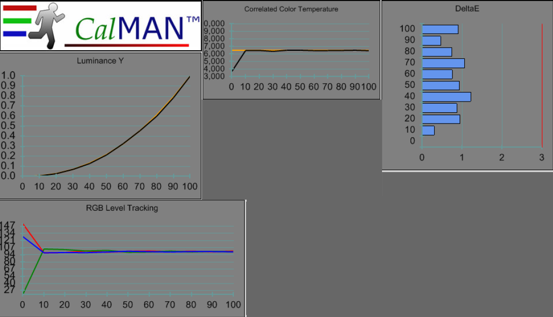

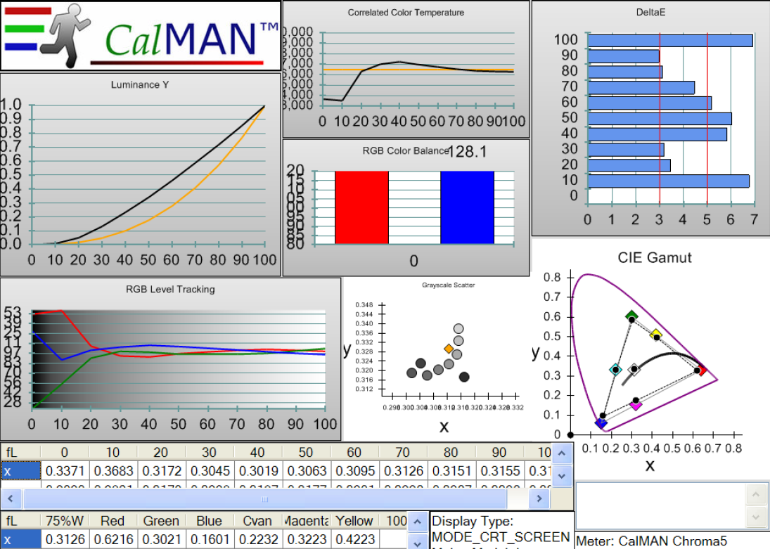

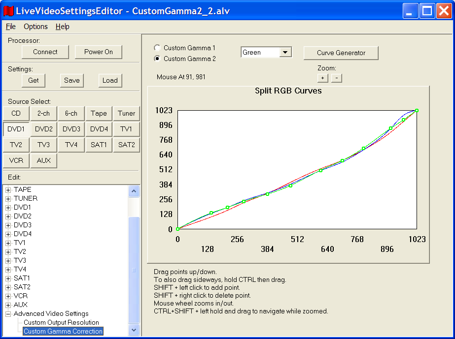

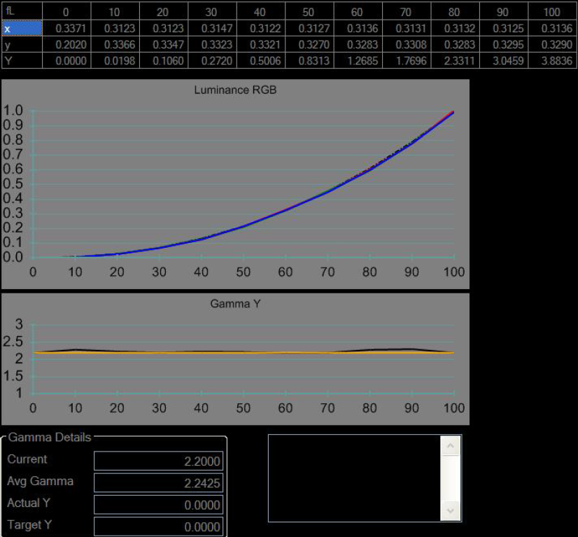

So Anthem has finally released new firmware for my AVM-50v that allows control of the VXP chip's RGB gamma curves. Rather than defocus the blue, I was able to painfully (the interface is horrid) do the full greyscale and this time with a proper gamma curve Very Happy
As I said earlier, with my Barco controls maxxed out to get the greyscale as close as possible, the gamma curve was a disaster (average about 1.5!). This is the correction I have applied in the VXP and the resulting measurements.
I must say everything looks amazing now, but I do wonder what's next... Would a Color Management System (CMS) make a profound improvement still?

These pics sum up the Before & After. The before shows the CIE gamut with HD145 filtered lenses - that has not changed. I suppose a full CMS would make the gamut even more accurate, but would I notice?

Posted: Thu Apr 19, 2012 4:28 am    Post subject:
I'm surprised you can get a grayscale like that without defocusing the blue. See this post and this post for an explanation of why you need to defocus.
You must be driving your blue really hard at higher IREs (which will probably shorten the blue's life), or you're running the R/G fairly low. But as you can see in the second link above, some people do prefer the hyper-sharp blue. Unless you have eagle eyes you won't notice it, but if you're really particular, you may prefer the tradeoff to get the sharp blues.
