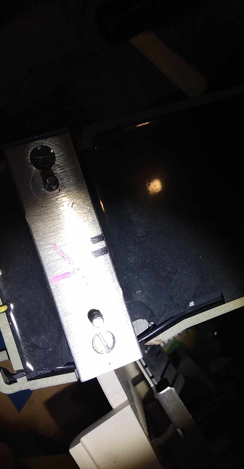

Soo after sleeping on this,
Carefully look at the direction of the possible arcing on the edge of the alu bracket... it's seems to be not from the inside, the damage is purely external,
So nothing on top of that with HV just the frame, so it can't come from the top
The inspection of the inside of the quad, along the side of the plastic enclosure reveal no burning marks witch I think would be impossible if arcing was from the inside to the outside, it's perfectly clean, and the damage melting would have been form the inside to the bracket...
The shape of the destruction seems to indicate arcing between the black HT return and the frame, but the wire is not melted, partially attacked like in the way of the arcing... so my guess is a bad return to the board ?? and arcing between the return wire and the edge of the bracket since this wire if the HT return is bad must go to some HV potential... but the path of less potential should have been at the connector anyway, and the insulation would have melt
Cleaned everything this morning and raster is stable, so mmm mmm not sure what is going on here, ever saw that ??
Thanks !!

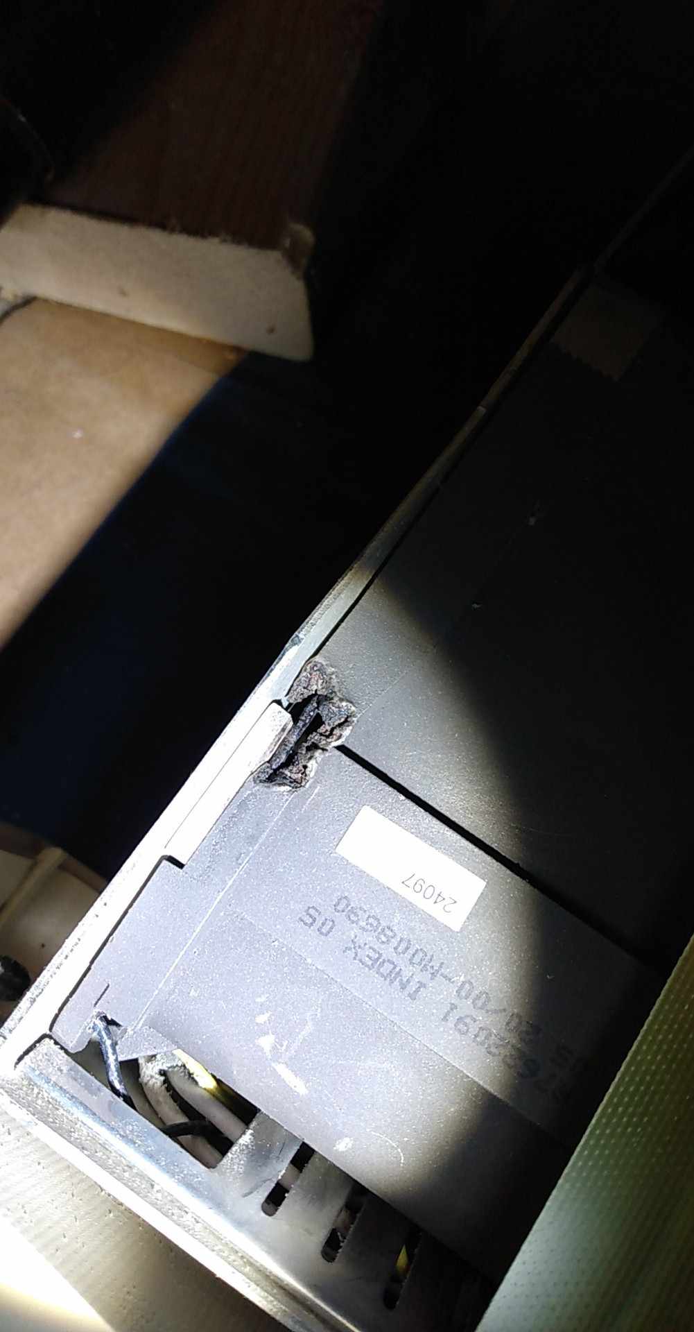

Posted: Tue Jul 30, 2024 3:24 pm    Post subject:
002
 Filename:  452541852_1281619419467759_1499829598922697265_n.jpg
 Filesize:  81.15 KB
 Downloaded:  67 Time(s)

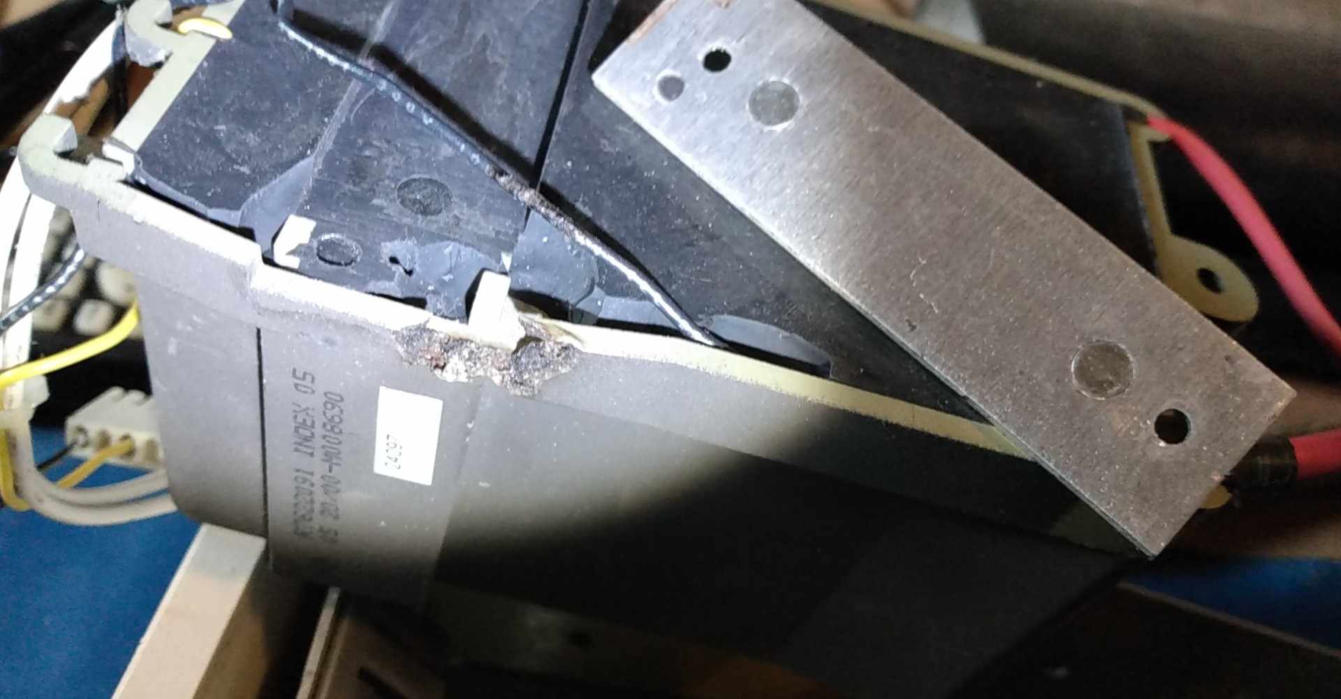

Posted: Tue Jul 30, 2024 3:25 pm    Post subject:
003
 Filename:  452843462_3795889927309072_2400272879275072195_n.jpg
 Filesize:  125.88 KB
 Downloaded:  61 Time(s)

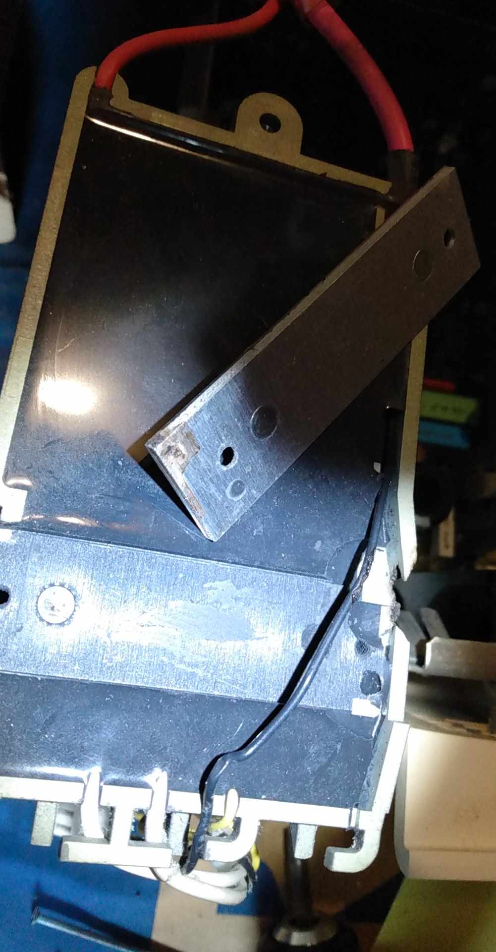

Posted: Tue Jul 30, 2024 3:27 pm    Post subject:
004
 Filesize:  105.33 KB
 Viewed:  1324 Time(s)

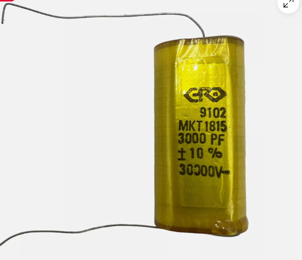

First step, super caps !! Need to test them, but will see what can be done with... 30kV caps Smile
Never heard of EFO caps, anyway will put them under stress before
ebay stuff, I hope size will not be to big,
https://ebay.us/FBfJnt
I trust more this than aliexpress obscur caps
 Filesize:  137.68 KB
 Viewed:  1250 Time(s)
