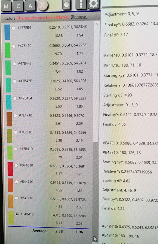

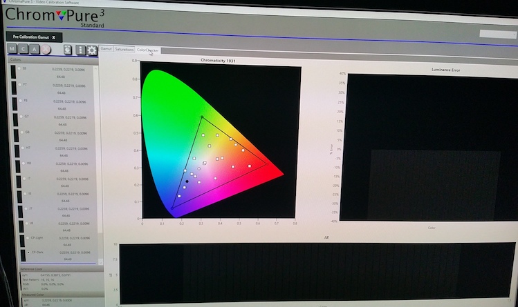

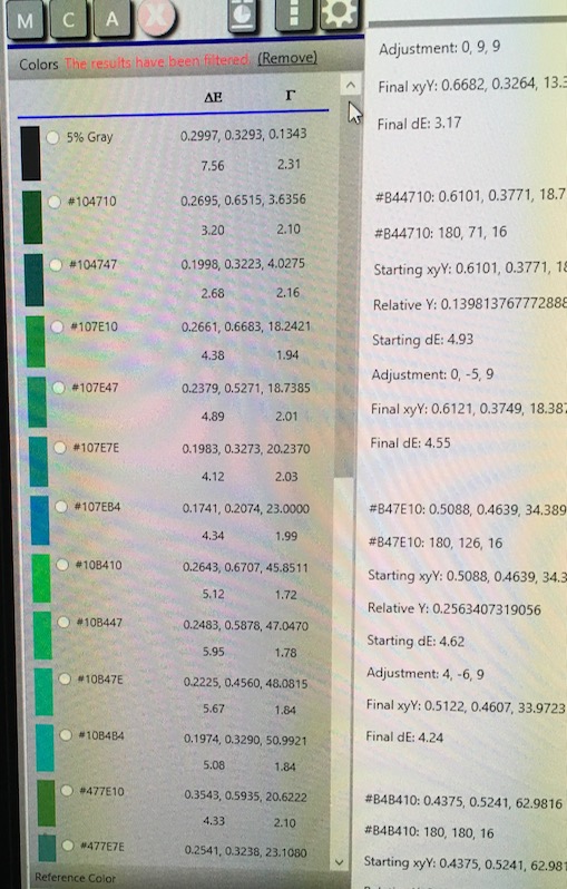

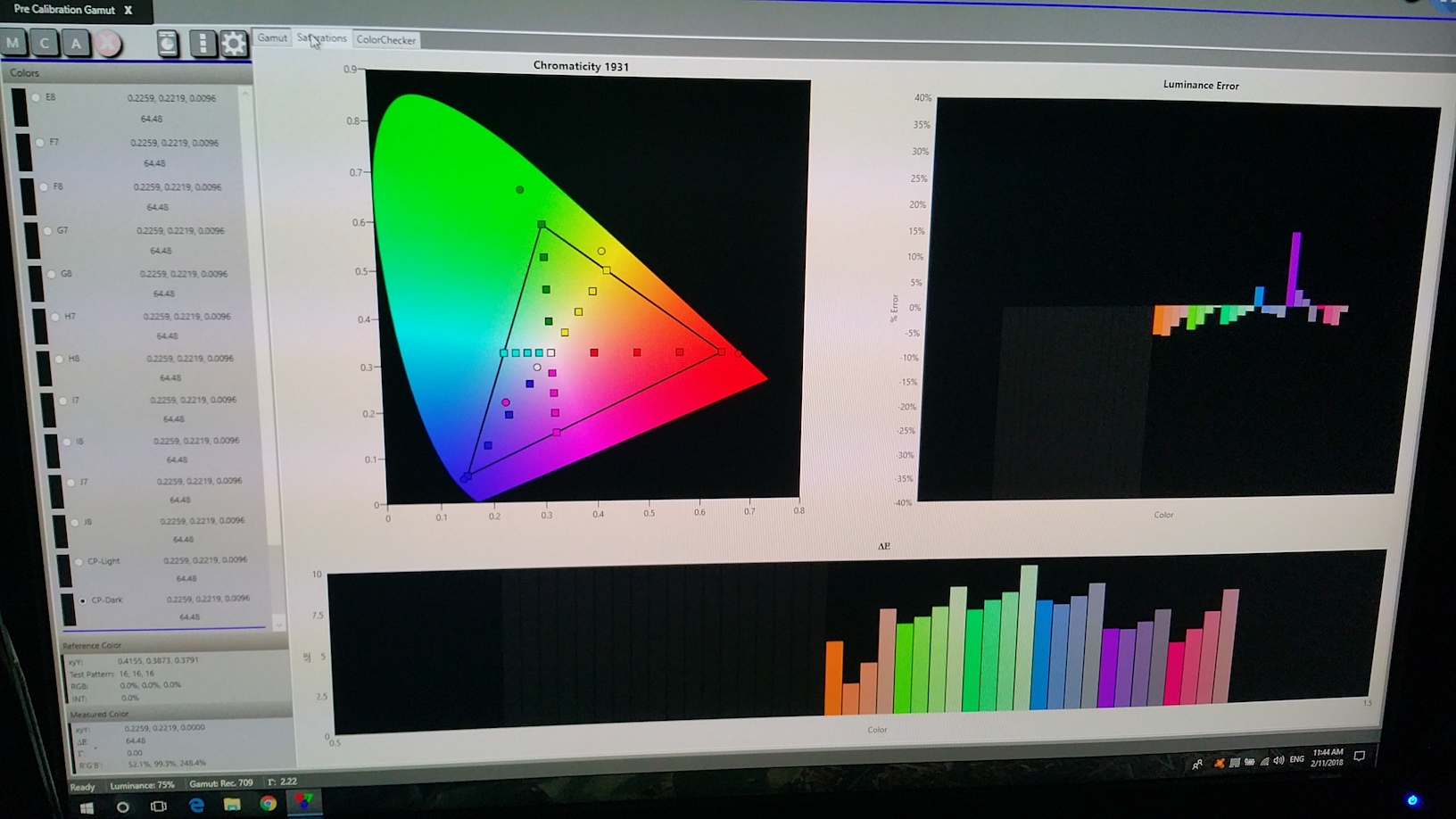

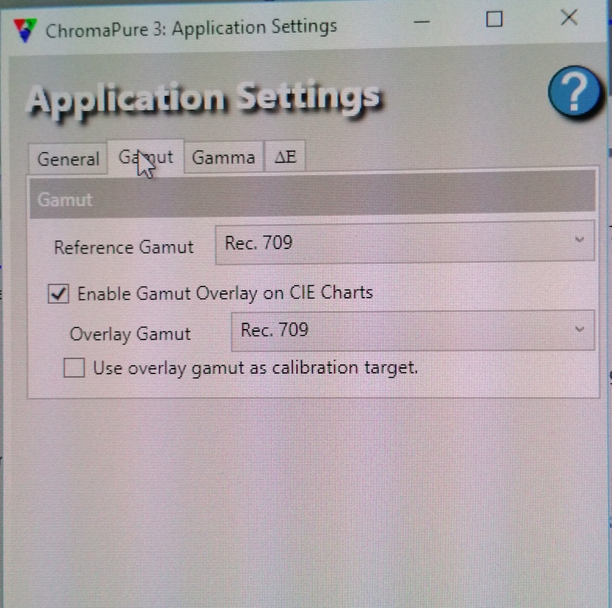

Posted: Sun Feb 11, 2018 1:12 am    Post subject: FullHD calibration

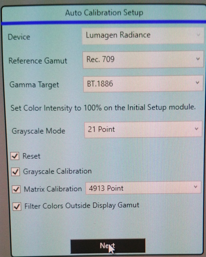

Everything was set at maximum (hopefully to get best results). Here's some photo's (sorry, most are too big). This is for a Rec 709, BT. 1886 calibration. I'm not sure if I have the settings at the best for this purpose and my TV. This is for FullHD sources. I have put further questions in the photo comments.
I ended up canceling it after a few hours as I wanted to watch TV! At the pace it was going it might have taken 6 hours (judging by how far through it was).

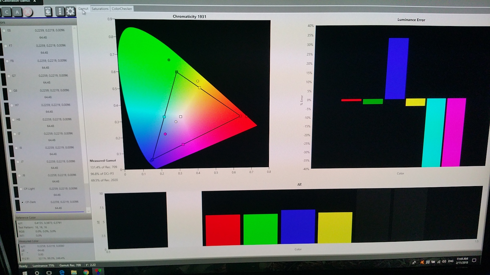

Pre Calibration Gamut. Anything of significance here?
 Filesize:  430.4 KB
 Viewed:  12703 Time(s)
 Filesize:  421.18 KB

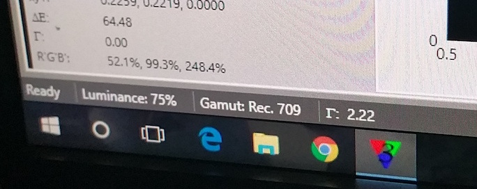

What is that Luminance 75%?
Also the R: 2.22?

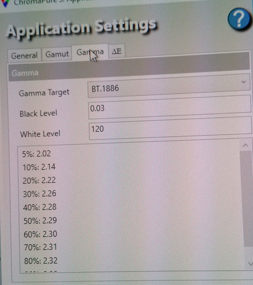

BT. 1886 or 2.22, 2.3, 2.4?
With OLED should Black Level be 0?
White levels higher with my TV?

1. Not sure about :
a. Greyscale Mode
b. Filter Colors Outside Display Gamut
c. Gamma Target

Just read in the Chromapure manual that selecting 4913 colours can take 'several hours'.

The 'cup of coffee' comment was definitely something I wrote back when 125 point calibration was the only option. You can still do that sort of calibration and get close to where you want to be to make sure it's all working as expected, and it'll be ~40 times faster.
So that what I'd suggest you do: Do a quick 125 point auto-cal and attach your results before and after report here. That's much easier for ChromaPure support to analyze.

Based on your screenshot, you attempted a 4913 color calibration. That would take hours to complete. I would strongly advise against that, at least when you are doing a standard 709 calibration. Start with a 125 point.

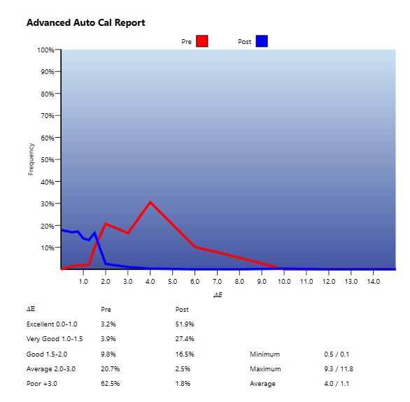

Also, for the post-calibration report there's really only a few pages that are relevant. Click the Quick Report icon at the top of the auto-cal page. This is the most important report page for auto-cal. See the included attachment.

Did the most basic calibration which from memory took about an hour (it was yesterday). That was with Chromapure 3 (latest version) and a new EyeOne Display 3 PRO on Radiance Pro 4242. Dim room with minimal other light.

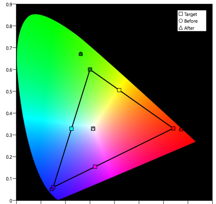

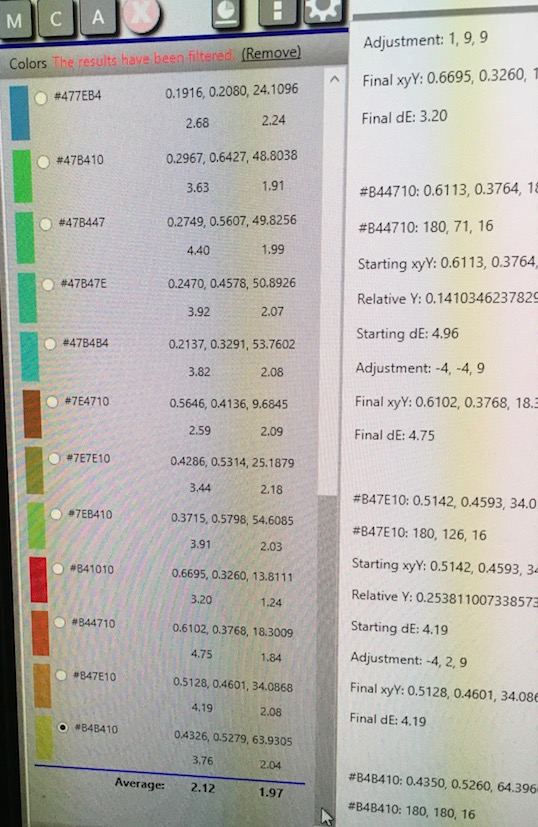

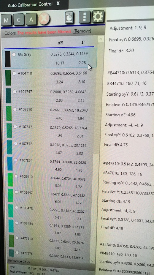

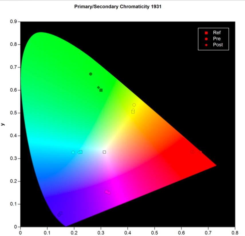

Red & green seem way out and the calibration seems to have done nothing to alter them? I tried remeasuring just those colours with an error over 2, but each time I measured the results varied wildly. Pics attached.
v. 2 report (with old meter)
Greyscale is worse after, but it seems better with red & green.

"Red & green seem way out and the calibration seems to have done nothing to alter them?" The screenshot you posted of the CIE chart shows red and green being altered quite substantially.

Ok, thanks Tom. That CIE chart is from the v. 2 calibration. It's the v.3 calibration that seems not to have changed red & green (see pic below).

2. Application settings - Gamma. Since I have an OLED that does absolute black and 1000 nits could Black level be 0 and White level higher? (I don't really understand what that setting controls).
