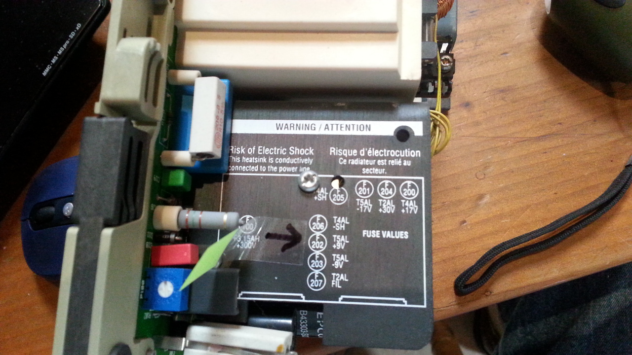

dentree wrote:
Would a faulty splitter cause the scan fail LED to activate?
I think the scan fail LED might be activated because the power is to low for the horizontal scan board. That board will shut down the machine with to low power because a scan fail would cause spot burn.
So my guess is to check the smps first. Now I do not know if the 808 smps is compatible with the cine 8 smps. I think the cine 8 has a power factor corrector board next to it but they might be different. If not the smps is the first board to try and exchange.
If it is the smps than it might be simple the 17 V that is adjusted wrong. It should be adjusted with an internal 32khz signal contrast and brightness to 50 and than 17,0V for the cine 8 and 808.
Looking t the pictures from a 808 the smps are the same.
Also look at the tutorial here:
http://www.curtpalme.com/Barco808_Layout1.shtm
There is a lot of information on the common failures of a 808. The horizontal or vertical scanboard is of cause another suspect.

Hi Casey,
Have just had the Cine 8 SMPS in the BG 808 trying to stabilize the voltage at 17, but the LEDS are all blinking, and the voltage is swinging wildly from around 13 to18 volts, so just keeps shutting down, however I have just gone through the fuses on the SMPS board and have found the one indicated in the picture has NO reading, all the rest give me a reading of continuity,
(the continuity has been tested with the fuses in situ) as they are all soldered in, have rung around but no one seems to know what I am talking about fuse is marked T5AL + 9V (FUSE F202)
on Curt's page he mentions Pico fuses (I do not know what that means, and it seems nobody I have spoken to are any the wiser either.
Anyway if I have done this right, I have at least found 1 problem relating to this board.
I have also decided that I am going to take down the Cine 8 and set both machines up on a table to look at the screen, that way it will be easier to work on them, but first to solve the fuse issue.
 Filesize:  418.81 KB
 Viewed:  5022 Time(s)
Posted: Sun Dec 28, 2014 10:52 am    Post subject:
Yeah no worries mate, a pico fuse is a smsll sized device to limit excess current flow.
Im not your best bet tonight as i have had my mate from Wisconsin here for a BBQ, and ive had 7 tallies. You know what that means Trev Wink To anyone else, it means im under the influence of alcohol... 7 tallies is a considerable amount!!

dentree wrote:
Hi Casey,
Tried the 808 smps in the cine 8 too?
Btw if a fuse blows there might be a reason. Your smps might need a pro to look at for repair.

Posted: Mon Dec 29, 2014 3:24 am    Post subject:
Replaced the fuse in the Cine 8 SMPS fired it up in the BG808.....ALL GREEN..... and was able to set the voltage at present to 17.2, will fine tune later, the 808 is only running on it's startup screen at present, Next I will put the Quad back into the Cine 8 and run it up and see if there are any errors showing on the Cine boards.....to be continued
Looks like you fixed it! Now if you have the cine 8 running exchange the focus yokes between 808 and cine 8.
Great work! Thumbs Up
