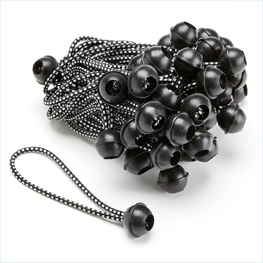

Then you just web the screen with rope or you can buy these bungee cords with balls on them that interlock
through a loop.
Amazon has them, click on pic to go to amazon.
