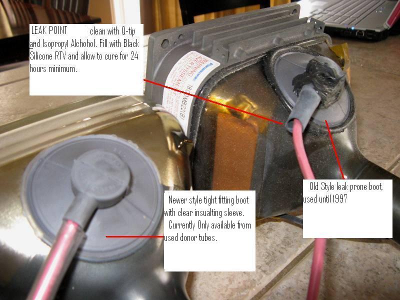

Posted: Mon May 30, 2011 6:28 pm    Post subject:
bigbri wrote:
yea cragr, I don't see any arch and although it has calmed down there is still a faint crackling.
Wit the machine turned off overnight, pop the plastic covers off the tubes. Clean the HV wires with Alchohol and clean cloth. If you have the loose fitting rubber boots clean inside them with Q-tip and alchohol. Now fill the boots with Clear or Black non-automotive RTV Silicone until they are full and seeping out . Allow to cure for 24 hours

Posted: Mon May 30, 2011 6:48 pm    Post subject:
did you remove the high voltage leads from the tubes? You shouldn't have had to if you just did a bellows replacement/clean. If you didn't, then I can't see the boots as a source, although disturbing them may have caused something if they are of the older vintage. Dragan's post is a fix. If it continues, buy some new ones from Curt. Dragan's fix was great when these HV leads were impossible to get new. Now I would just buy new all day long. They are very difficult to leak proof once they start to leak.

Posted: Tue May 31, 2011 6:56 pm    Post subject:
Good point, I remember now Curt has these brand new ( I need to edit my pic : ). I believe you have to pull the tube out of the machine though and remove the yokes to really get access to the boot and insure a proper install.
Those old boots can start to leak if you just look at them wrong. Typically moving the HV wire around + the conductive Black Carbon Sooty build-up on the wire is enough to create a leak-path.
