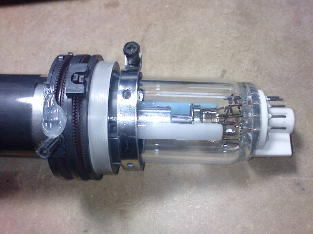

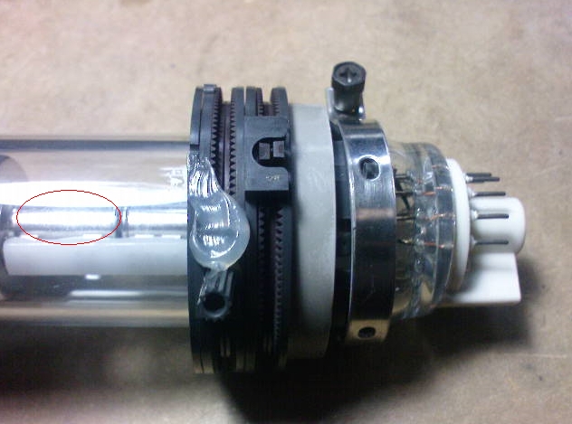

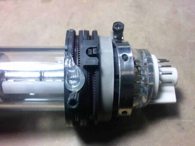

What confuses me is that Electrohome seems to have mounted the cpc magnets the same way in the factory. I have a set of 8" tubes out of a 8500 which also have the cpc magnets all the way up to the focus coils, and they are glued to that position, so I think they were mounted like that in the factory. Then again, when I look into my Ampro 3600 (and also at the pics in the setup tips for the Ampro), the cpc magnets are mounted as close to the neckboards as possible.
Look at these pictures:
this is approximately the position of the 2-pole magnet in my Ampro 3600 if transferred to the 2-pole-only cpc magnet of the marquee tube

This is the position of the cpc magnet from a Marquee 8500 (2-pole only)

Posted: Tue Jun 01, 2010 10:56 am    Post subject:
They go over the front "cylinder".
See pic:
 Filesize:  170.53 KB
 Viewed:  8060 Time(s)
Posted: Tue Jun 01, 2010 12:13 pm    Post subject:
Cheers Mark, that is pretty much exactly where mine would be, i marked their locations before i removed them from the necks first time around, and they are about the same place the Sony had it's CPCs before i pulled the tubes out of that ( which was the first time the Sony ever had it's tubes out. )
