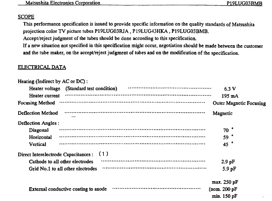

By the way, does anybody know the approximate capacitance between anode and aquadag for a P19 tube?
Pier
The anode doesn't need a real sturdy connection because the current is max about 0.01 Amps. Sometimes a bad anode connection will make the image bigger than it should be then it shrinks down to the right size goes large again and repeats.
The capacitance spec:
Scott
