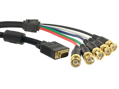

Have a read here: http://www.curtpalme.com/CRTPrimer.shtm
and especially here: http://www.curtpalme.com/CRTPrimer_17.shtm
It may help explain things to you. If your projector has the corect input, that is, 5 BNC connectors labeled RGBHV or 4 labeled RGBS you can use what is called a break out cable. It has a VGA connector on one end and 5 BNC connectors on the other. You may have to tie the H and the V together to get a picture that doesn't roll. To do that you need a BNC T adaptor. You plug the VGA cable end into your video card on your computer but first set the desktop for something like 800x600 or 1024x768.
BNC T adaptor
 Filesize:  8.44 KB
 Viewed:  12634 Time(s)
VGA ( aka RGB ) to RGBHV breakout cable.
 Filesize:  22.09 KB
DARNOLD
Joined: 14 Mar 2008
Posts: 61
Location: St. Louis
Posted: Sat Mar 15, 2008 6:55 am    Post subject: baadda boom baadda bing!
THANK YOU!
