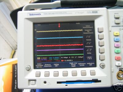

And one that I want:
http://cgi.ebay.com/Tektronix-TDS3014B-Color-Digital-Phosphor-Oscilloscope_W0QQitemZ300200324216QQihZ020QQcategoryZ104247QQssPageNameZWDVWQQrdZ1QQcmdZViewItem
Very Happy
Gawersh dat's purdy.
Very Happy
What kind of memory card does that thing use? Shocked I don't think I've ever seen one that big. Wink
Very Happy
I have a similar one to that. Mine is the TDS3052. Its the 500Mhz 2 channels version. Smile
