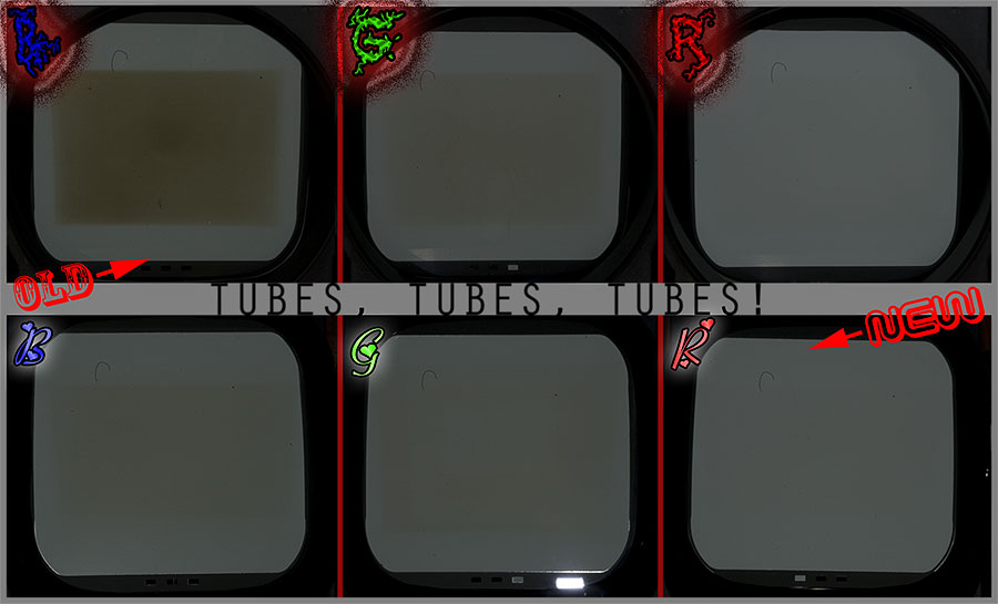

OK, having spoken with the anonymous donor, 'DEEP TUBE', I have come to a conclusion about the swap. Therefore, I present the old and the new! I am a happy man!
(These shots were all taken with the same settings on the camera, with flash, so the differences between are representative and the quality as shown is pretty accurate).
(In case you're wondering: Yes. I am crazy.)

well the "new' ones ain't exactly pretty but it's a step in the right direction. What counts is the experience you've gained, now if you do get some really nice tubes you won't have to gamble with them.

Persecution complex? Razz Gotta say it.... I agree, you've made a step in the right direction. Those new ones aren't perfect, but for dang sure better than what you had. Did you actually watch it with those old tubes? The ones on my other Marquee weren't as bad as your old ones, but I couldn't stand to even fire it up and see that nasty brown all over the screen....
