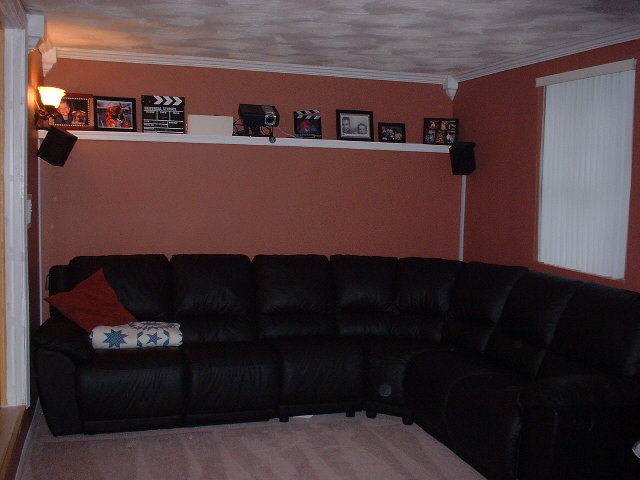

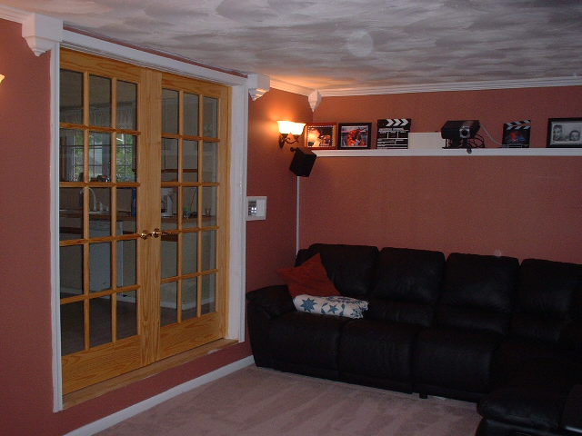

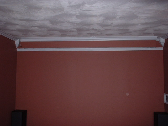

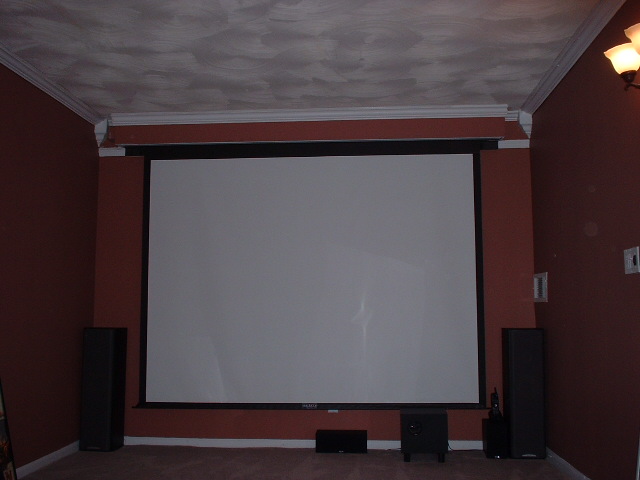

The larger foot print of the CRT units are the only thing that might prvent me from an upgrade but all in all I am happy with the Dlp projector I have for now. My theater dimensions are approximately 19' x 12.5' with 8ft. ceilings.

Posted: Thu Nov 29, 2007 5:24 pm    Post subject:
You can certainly fit a CRT into that room. My HT is about 13x14 with a 7'9" ceiling, and I've had an XG, a G70, and an 8500 hung in there. All of which are good-sized projectors. The projector is certainly noticeable Smile but so is the picture quality.
But if you're happy with your DLP, it is definitely a lot easier.

Posted: Thu Nov 29, 2007 6:55 pm    Post subject:
Although I would be open to the larger unit I would also be up to the daunting task of qualifying for the WAF (WIFE ACCEPTANCE FACTOR). Since the smaller unit and the retractable screen are part of the system it isn't as "in your face" and therefore less arbitrary to my better half -Hey, marriage is about concessions sometimes.....
