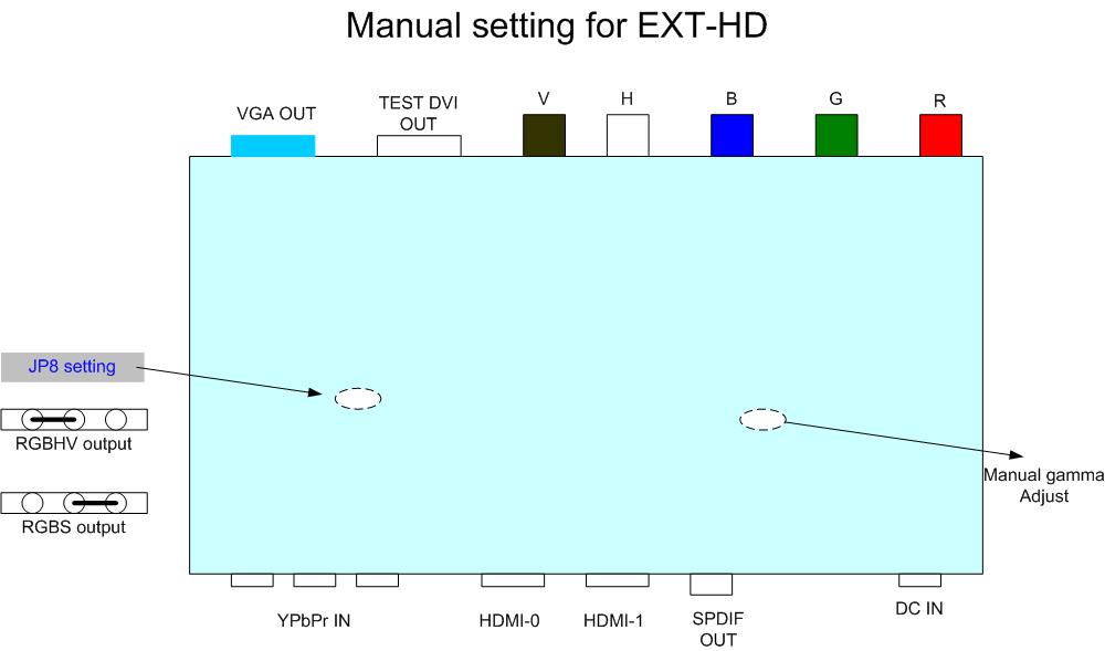

hi, the shifting problem will need adjust your projector's shift to correct it, or you can try set RGBS mode to your ampro!
you will need open the box, there is a jumper can set RGBS output!

and i upload a setting picture of manual gamma setting and RGBS output mode!

i upload a setting picture of manual gamma setting ...
When would you want to use the manual gamma adjustment and not the remote control? How do the two work together?
