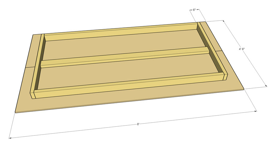

Posted: Fri Nov 16, 2007 6:02 pm    Post subject:
Guys, the roller to apply laminate is called a "J-roller":
It's designed to apply very high pressure to a very small area - specifically to bond contact cement - which is what adheres laminate to the substrate (in most cases MDF). The way you do typically do laminate countertops is apply contact cement to both the substrate and the backside of the laminate, and let it dry to a tack 10-15 minutes. You put furring strips or spacers on the substrate, then you carefully flip the laminate and lay it on the substrate. The strips keep the two pieces from coming in contact and allow you to position or re-position the laminate on the substrate. Once you're satisfied with the position, you slide the strips out and let the pieces touch. Once the two pieces touch each other, it ain't coming back apart. Then, you use the J-roller, rolling from the center to the outsides to push any air bubbles out. Once you're done, the laminate isn't going anywhere... ever. It's perfectly flat and smooth. The only worry is that you get sawdust or other large particles sandwiched between the two.
That's basically how I built my screen. I built a 2x4 frame, screwed two 96x27 pieces onto that frame, then screwed a 2x4 long-edge down onto the seam between the two sheets. No biscuits, glue, or other fasteners. I didn't even fill any of the screw holes in the MDF - I just countersunk the screw heads so they were flush with the surface of the MDF. I had NO waves, seams, ripples, bubbles or other imperfections whatsoever. I used 2x4's and 3/4" MDF along with the heavier laminate. The screen ended up being horribly heavy. If I were to do it again, I'd use 1/2" MDF and 1x material instead of 2x material.
Total cost was well under $150. $100 or so for laminate, $15 for contact adhesive, $10 or so for some studs, and a box of course-thread drywall screws. I attached it to the wall with a 2x4 that I ripped into a French cleat on a friend's table saw. Total assembly time was probably a couple of hours once I had all the materials.
The 2x4 design turned out kind of cool. The screen is spaced out 3.5" from the wall. I put an outlet directly behind the screen and added rope light around the screen, so I have a cool halo around the screen. It's on only before and after movies.
Here's the screen in SketchUp:
