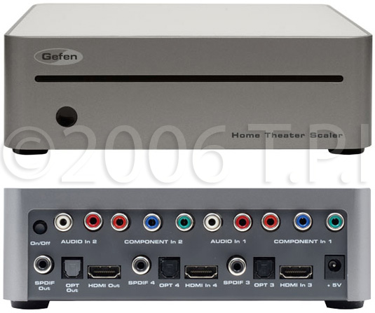

I have seen a few references to the cheap Gefen HD Mate Scaler on this forum. There are also the equally cheap Home Theater Scaler and Home Theater Plus Scaler. Is there anyone who has used one of these on his CRT?
Spec-wise, it looks good:
Features:
Both digital and analog inputs are format converted and pixel re-scaled through the HD Mate Scaler. It outputs a large range of formats and resolutions that will easily match the native resolution/ format of your display to ensure highest picture quality.
DVI/HDCP compliant input: Operates up to 165Mhz (Up to UXGA @60Hz)
Supports digital HD output up to 1080p.
Integrated 8-bit triple-ADC/PLL.
Integrated DVI/HDCP compliant receiver.
Dual high quality scaling engines.
Dual 3-D motion video adaptive de-interlacers with smooth low-angle edge.
Automatic 3:2 pull-down & 2:2 pull-down detection and recovery.
High performance frame rate conversion engine.
The Proprietary Advanced Color Engine technology gives: Brilliant and fresh color, Intensified contrast and details, Vivid skin tone, Sharp edge, Accurate and independent color control
3D noise reduction on analog inputs only.
Operates through on-screen OSD menu control and remote control.
DVI-I input and output accepts both analog and digital video
Aspect Ratio Control
Digital Audio Delay to match audio/video timing
Less then one frame delay allowing for gaming
Specifications:
Digital Video Amplifier Bandwidth: 1.65 Gbps
Component Video Bandwidth: 350 Mhz
Input DDC Signal: 5 volts p-p (TTL)
Input Video Signal: 1.2 volts p-p
Single Link Range: 1080p/1920 x 1200
Input/Output DVI Connector: DVI-I (29 pin) female
Component Video Connector: 3 RCA
Digital Audio Connector: optical TOSlink and coax SPDIF
Analog Audio Connector: mini-phone stereo 3.5mm
Power Supply: 5V DC
Power Consumption: 12 watts (max)
Dimensions: 6.875"W x 2.125"H x 6.875"D
Shipping Weight: 6 lbs.
http://www.gefen.com/kvm/product.jsp?prod_id=4173
What I would like to know if this is going to work with my PS3, connected to my BarcoReality 909. The 1080p output of the PS3 is great, but all other sources that are not 1080p are shown native. What I want is to upscale SD and 720p to 1080p, with timings that my 909 likes.
Anyone?
