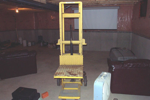

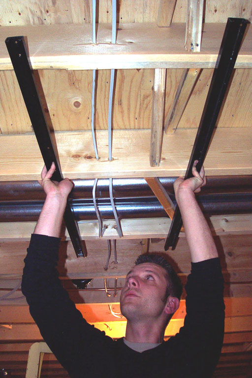

So here is my problem with the joists.
I'm going to Mickey Mouse some "L" shape brackets and weld them onto the Unistrats on the wheekend. I have an access to a brake press, so I might as well do it right. That way I'll run some bolts through the brackets and through the side of the joists and that should do it. So I'm back to the drawing board, but thank god I don't have to return that lifter back to work for a while or I'd cry.
Chris.

Posted: Thu Nov 08, 2007 10:24 am    Post subject:
Are those 2x8 joists?
Posted: Thu Nov 08, 2007 11:15 am    Post subject:
look like 2x10
Analog_Alpha
Joined: 17 Jan 2007
Posts: 89
Location: London, Ontario
Posted: Thu Nov 08, 2007 4:56 pm    Post subject:
2"x10"
Chris.

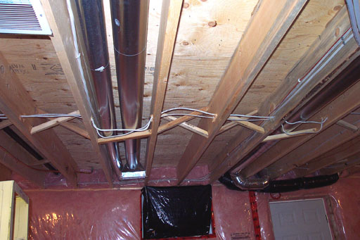

dbaisey
Posts: 821
Posted: Thu Nov 08, 2007 6:57 pm    Post subject:
I would pull all the wires now for the next 10 years Very Happy unless you can install raceway off to the side wall location. Doug

Posted: Thu Nov 08, 2007 7:02 pm    Post subject:
listen to doug.
the ONLY regret i have when i did the room last year was not putting conduit to the projector. i can fake it by running future cable in the crown molding, but i really should have done conduit. someone named Curt recommended it too Smile
i ran interconnect and speaker wire to 7.1 locations so i'm good there, and i ran RGBHV extron cable to the PJ, but i suspect that with the vid standards/cables changing like they do, i'll be snookered one day with only the 5 wires in the ceiling.
and to be honest, after i ran some conduit for a later job it would have been SO much easier than pulling the wire.
dbaisey
Posts: 821
Posted: Thu Nov 08, 2007 7:39 pm    Post subject:
Other suggestions: Drywall dust contamination and CRT. Any opening on the ceiling needs to be sealed the best you can do. Any dust will find its way to the back of the lenses or crt face. Its just going to happen even with LC. Nothing worse then the first time you turn on the fans suck it in.
Pull the power for the projector as a designated circuit without sharing neutrals. Keep power cut in box's separate or partitioned from the low voltage / signal cables.
Future hush box venting? Doug

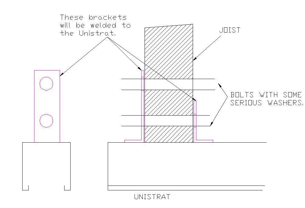

Nail some 2x10's up there to attach the unistrut to.

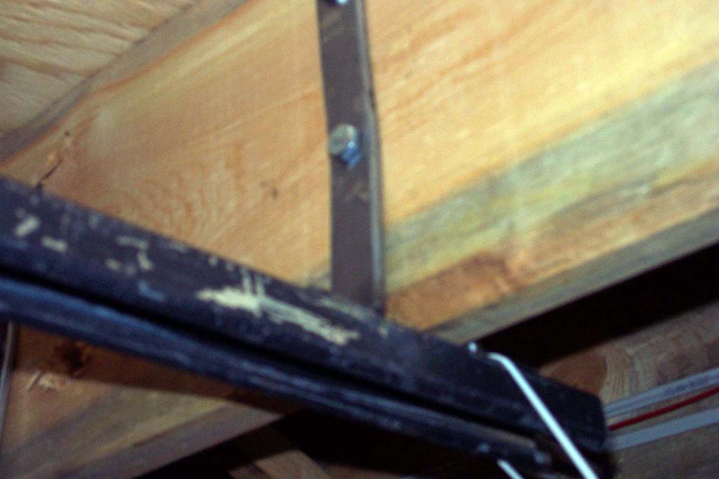

Posted: Fri Nov 09, 2007 4:26 pm    Post subject:
Thanks for the reply. I know what you mean, but by doing that I’ll be bringing the PJ even lower and closer to the floor. This attached picture is what I have in mind and I’m planning on using 6 brackets per Unistrat, or 18 brackets in total. If everything goes well I’ll have them up by Sunday. I'll be sure to test the welds by hanging a lot of weight on them before they'll go up.
Also going back to the cables….. Once I have the PJ up on the ceiling I’ll be sure to run as much wire as I’ll need until I retire. I just want this PJ on the ceiling so I can clean up the floor and start bringing all the needed material in. I actually just finished putting surround system (combination of JBL 800s + Harman receiver + turntable Evil or Very Mad ) in the garage and I run all the speaker wire, internet cable and phone line right inside the walls after I soundproofed it. So I’m going to try to do as clean set up in the basement as I did in the garage.

Posted: Fri Nov 09, 2007 11:11 pm    Post subject:
Hey alpha,
Lookin good there. That's a nice sized space you have.
The only problem I see with your design is the bolts for your brackets need to be in the upper half of the joists. Just make the brackets that you are welding to the strut longer.
If you put them that low in the joists you will essentially render the 2x10's useless for live loads with the span you have. With the holes in the bottom half and that behemoth of a PJ pulling down you would be using the least amount of "meat" on the joists, compromising the parallel to grain shear strength.
It would probably never give you a problem, considering how many brackets you plan to use. But, if it were mine I would most definitely try to get those bolts as high in the joists as possible.

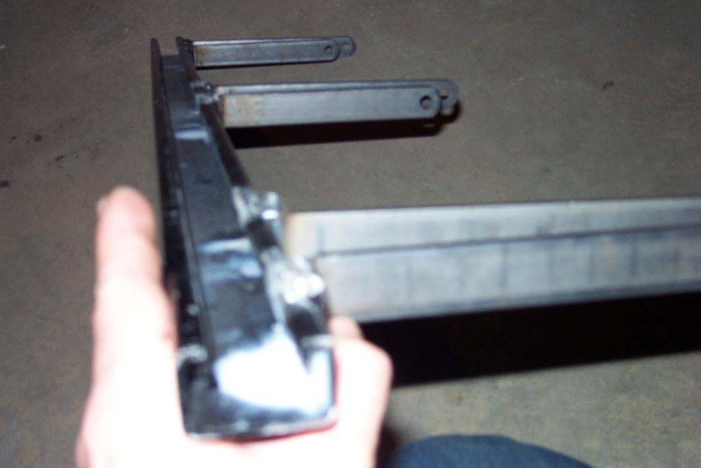

Well, brackets have been welded.
First ones came back to me welded on the wrong side.
The decision had to be made as to either make new ones or rotate the house 90 degrees around the brackets (no WAF there).

Analog_Alpha
Joined: 17 Jan 2007
Posts: 89
Posted: Mon Dec 10, 2007 1:41 am    Post subject:

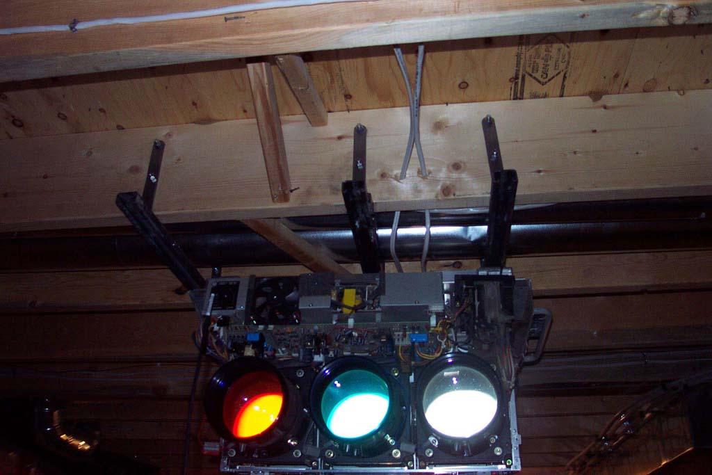

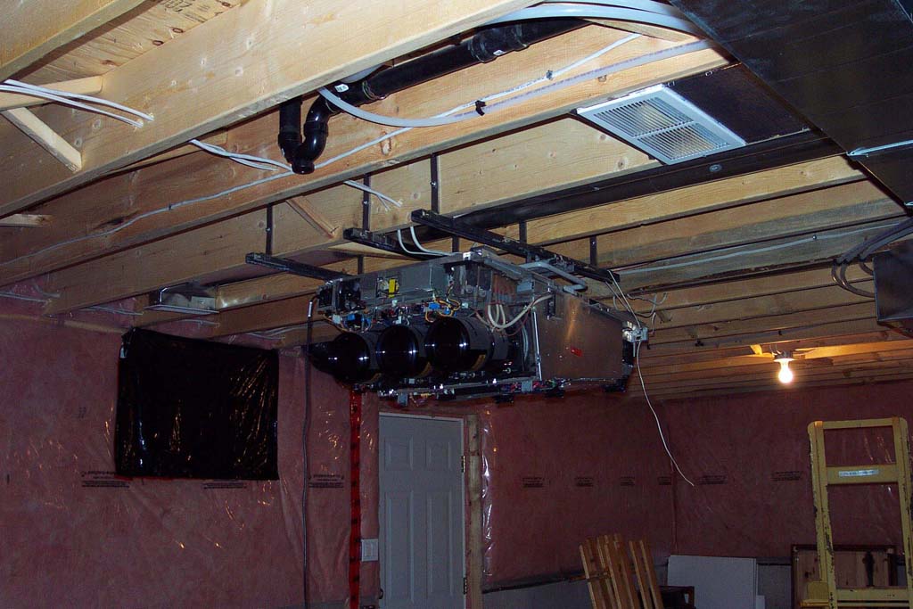

So a new batch of brackets was made. Finally the puppy went on the ceiling.
When I tipped the PJ on it's belly, the error board decided to split itself up in three pieces. PJ was working fine, except I could not get into the Serviceman menu. I actually thought I screwed something up. Anyways, replacement board came in very quick from Curt and after installing it, PJ is back to normal.
The case will be sprayed with Mystique type of paint (think limited edition Fords)
http://rides.webshots.com/photo/1070756618046105792XslGqt
at least that's the plan. I have to talk to one of my buddies to trick the case out for me. From doing some research on this type of paint, the clear coat is the hardest thing to do.
This should make the case look one of a kind.

I still have to level the PJ 100% and make it square to the screen, but the adjustments are there, so there shouldn't be any problems.
