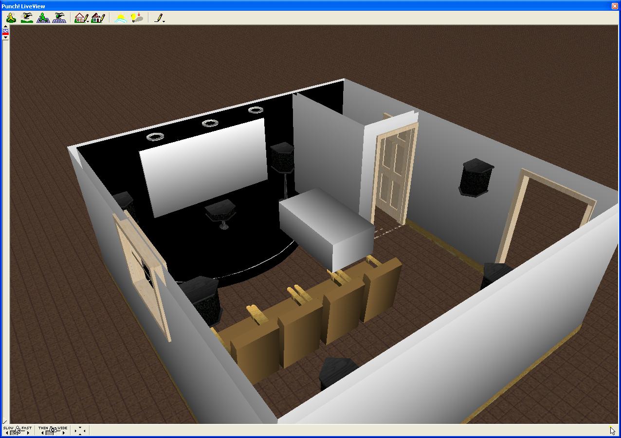

I am trying to decide what to do with my surrounds and rear speakers. I have to run the speaker wire now and I really need to finalize the decision as to where and how these four speakers will be implemented. I have Paradigm book shelf speakers. 2 Focus for the surrounds and 2 Mini Monitors for the rears. My first inclination was to put them on 36" to 48" stands.
Here's the problem. My room is not large and it would really be nicer if they were off the floor and mounted on the walls. I am concerned about the additional sound transfer into the stud walls and then up into the main floor. (This is a basement theater with all concrete walls already studded and insulated). Is there a magic solution for mounting these puppies to the wall but acoustically isolating them at the same time?
Thanks Guys!
Preliminary rendition. Basic dimensions are 17' 10" long by 16' 10" wide.
 Filesize:  130.86 KB
 Viewed:  10094 Time(s)

the firmer you attach them to the wall, the more transfer. the less firmly you attach them to the wall the muddier the sound.
rock. hard place.
consider using mounting brackets for them, many many surround speakers (including my Martin Logans) use a mounting bracket.

Thanks for your reply Zaphod. That was exactly what I was thinking.
Although I have just had a brain storm! I have concrete walls behind the stud walls where I am placing these speakers. All I need do is to come up with a mounting method that secures some speaker brackets to the concrete wall and passes through the stud wall without making any real (acoustic) contact with the stud wall.

I made brackets for my rears, (I have speakers for mids just nothing to drive them yet). They're a hard mount to the walls but the studs are isolated; eg, floating. A friend of mine created suspended "mounts" for his using rubber and springs and stainless bits and parts. I simply don't know enough about the science of creating 'the' optimal audio environment so I plead ignorance in the case of my HT.
If your 3D rendering is accurate in it's configuration, at this point I think you're going to have a more difficult time achieving good imaging with the current/proposed speaker placements. You may end up not rigid mounting much if you follow good placement laws.
While Googling to find mounts for you I stumbled across the paragraph (and much more) below:
Courtesy of Galen Carol Audio
"For proper imaging to take place, sound from each speaker must arrive at the listening position at precisely the same moment. This requires that the speakers be exactly the same distance away from the main seating position. We're talking about precision here. Difference of less than ¼" will be audible in better systems to careful listeners. "
There's ALOT more where that came from at: http://www.gcaudio.com/resources/howtos/speakerplacement.html

but your processor should have adjustment for the distance to each speaker. better processors will have seperate measurements for the left and right surrounds.
once weird thing about the Sony EP9ES was that the center could not be registered with a distance more than the fronts. you had to have the center at least as close as were the left/right.
i remember a DVD player (JVC i think) that had the delays on it's 5.1 outputs measured in milliseconds. they had some math to convert from linear to temperal measurements, but talk about precision Smile

I'm sorry, but that's a load of crap.
What does Galen Carol Audio think? That there's ever only *1* person sitting in the home theater watching and listening? Gimme a break, it's a home theater. And like others said, if you move a little bit, it's the same as moving a speaker a little bit.
Even with 1 person, that's what speaker delays are for: To compensate for differences in placement. I use bipolar speakers in the rears like the ones in the original post picture (mine are the Paradigm Signature ADP's). They really give a 'disperse' sound field. I spend a whole evening trying various locations at various heights and positions before settling on something similar to the original poster.
Right now I'm 5.1 but when I go 7.1 in the future my speakers will be placed almost exactly like in the original picture as my room is very similar (slightly offset with one rear off to the side more than the other).
For what it's worth, I'm very anal and in my testing I did try moving that farther rear speaker against the wall and also putting it up closer to the listening position so that it was equal to the other speaker and it make zero difference once you dialed in the speaker distance in the preamp.

I thought my proposed speaker placement might draw a comment. Another way to do the room would be to extend the closet further to the back. Then mount the right surround on the closet wall. The problem with this idea is you narrow the access into the room. This is especially true if the speakers are on floor stands.
As Zaphod indicated my plan was to use the speaker distance settings to compensate for the unbalanced surround placement. Not the ideal... but workable.
My goal now is to find some off the shelf speaker brackets that are extensible enough to attach to the concrete wall and protrude through the stud wall.

and get yourself a sound level meter at radio shack to make sure that your levels are balanced out. you might have to tweek the far right surround a bit louder as it is further away. your milage will vary. trust your ears.
