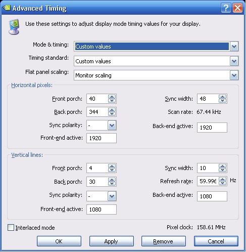

Mmm... troubles in VP50 land. When i try my best HTPC timings for 1080p on my 1209s on the VP50, it can't keep the 60Hz lock. The VP50 falls back to a louzy 57Hz...
Only thing i can do so far is decreasing the horizontal res to 1815 pixels, so i got 1815x1080p60...
Is the bandwidth of the VP50 limited under the 165Mhz for HDMI 1.1? I'm a bit dissapointed it can't handle this.
Below are the timings i normally use on my HTPC:

Firmware is 1.04, the latest. Funny thing is that the timings showed in the screenshot are under the 165mhz limit, but still the vp50 can't handle it.
Found out that with the settings in the screenshot (which are PERFECT, and mandatory for the Barco 1209s) as soon as the horizontal back porch exceeds 200, the vp50 starts decreasing the frequency. At the moment the H-Back is about 320-340, which is needed for the 1209s to give a good picture, the vp50 can't lock on 60Hz anymore, and is maxed out to 57hz.
A Barco 1209s is very anal about timings, the only way to get a good 1920x1080p60 is by using timings like i showed, it can vary a bit on different boards, but not much.

Ok, i've emailed DVDO with this... this is the reply... guess i was right all along... :
Thank you for taking time to send us your e-mail. The VP50 has a limit of 150MHz in software. This is why the frame rate drops down when you increase the H back porch (to accommodate for the increased bandwidth. I have brought your issue up to the engineering team for evaluation and will keep you updated on the matter once I have more information available. If you have any further questions or concerns, please feel free to contact me either by phone or e-mail. Thank you.

Without being blunt, i think this is a major issue on the VP50. If i knew this upfront, i would never have purchased it... i assumed that by implementig HDMI on the VP50 they would also comply to the 165Mhz bandwidth... pity.

Great news on AVS, from Josh (DVDO product manager):
The forthcoming Beta version for the VP50, v1.05, includes the following bug fixes:
1080p-24 Input to 1080p-24 Output - There should be no tearing or judder
Improved 1080i-50 Deinterlacing - In "Auto" mode 1080i-50 deinterlacing is improved
Flashing 48 Pixels - The flashing 48 pixels at the top of the screen, that appeared sporatically, are no longer...
Removed Limit on Scaler - Previously the scaler was limited to 150MHz. The new limit is 165MHz.
This version could be available as early as tomorrow.
This would solve my problem! Great!

Just uploaded the firmware, works like a dream Thumbs Up Full 1920x1080@60Hz using the Barco 1209s timings!
Found a bug as well, 60Hz lock mode doesn't work, even though i can select 60Hz manual. Will report this to DVDO.
