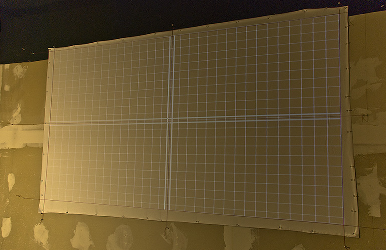

After finding that my 'screen' (read: backdrop canvas I hung up because it looked white at the time) is yellower than a men's room full of bug-lites, I decided that if I'm going to do a real evaluation and setup I needed a less thrown-together testbed.
Right now the PJ is set up on a desk in a cleared-out storage room in my business, so I can play around a bit. I grabbed some blackout cloth because the 'real' fabric is a bit translucent, some blackish black fabric to do the ceiling and the background, and an ever-loving crapload of thumbtacks.
Tonight I put the top section of black cloth up, and put the blackout cloth (which is white-ish, but still kind of yellow) up over that. To align the screen, I made measurements and strung high tension red nylon line across the top, middle, bottom, left, and right of the 'screen' (which is centered on the wall horizontally, and positioned so the rasters are centered on the PJ vertically).
So, the image is about 91" wide.
The plan is to put the real screen material up over the grid I made, and then put black cloth on the sides/bottom/top to do the borders. That way if I want to do a resetup I can pull off the screen fabric and have the grid lines there.

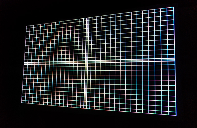

After redoing the geometry and a quick convergence, I grabbed some shots. Pretty happy with it so far; just the switch to the blackout cloth has made the whites considerably better, so I'm gaining some hope that despite draganm's proclamation I *will* be able to get white out of that tube. Very Happy
There are still some fairly major geometry problems, so it all needs to get redone again, but it's the best the thing has looked. Woohoo! This is gonna rock when I get it in the HT!
...with room lighting so you can see the setup and the guide lines (no, I did NOT set up the PJ first and then put up the border lines... Wink):
...and how it looks with the lights off:

Posted: Fri Sep 14, 2007 5:49 pm    Post subject: Re: ToastyBarco gets another setup
sure, and you can also piss in the snow and make "Lemon sno-cones" but you migth be the only ones who eats them. Wink
Posted: Fri Sep 14, 2007 6:00 pm    Post subject: Re: ToastyBarco gets another setup
draganm wrote:
Luckily all my friends are still eating crapcones, so they think it's fantastic! Very Happy
