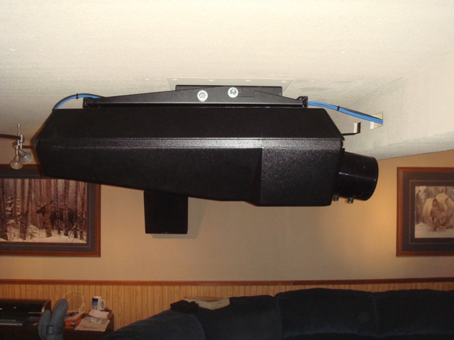

I assume that if greater raster area is used the projector would need to move closer to the screen. If this is the case the mounting position of the projector is constrained by structural elements in my room. I suppose the screen could be brought closer to the projector. I recently installed the projector and have attached a photo.

Posted: Tue Sep 09, 2008 6:59 pm    Post subject:
Very clean install, fb. I'd recommend moving the screen a few inches closer, if possible. Your phosphors will thank you for it, with increased lifespan and greater brightness (at a given drive level).
- Tim
Posted: Tue Sep 09, 2008 8:43 pm    Post subject:
Yup. You look like you could go 4-6 inches closer. The other option as you mentioned is moving the screen out (actually quite simple - just use some blocks or offsets).
