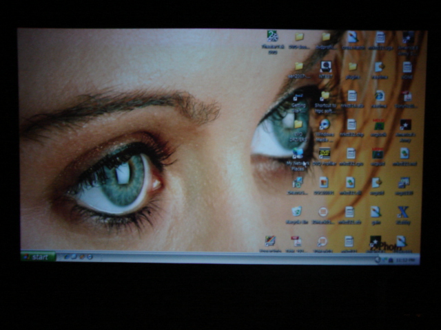

Posted: Sat Aug 25, 2007 5:45 am    Post subject:
heres a shots of my 1252 @ 1184x 666. (pic compliment of Z-Photo)... mmmuuch better than s-vid.
ok, i was just looking for a reason to post new screen shot, im much hapier with PQ switching from 1280x720 to 1184x666.
