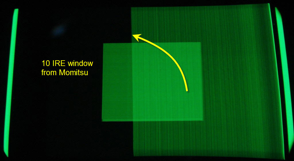

I've noticed some strange things (raster artifacts?) on my 8500. It's only noticeable at very low IREs. The attached pix (taken through the green lens) show what it looks like.
8500raster.jpg is a 10IRE window from Avia. Notice the "curtain" of noise or whatever on the right side. It almost looks like a folded raster, except the part that looks like a "raster fold-under" (on the right side) is actually not the edge of the raster. The bars on the sides are a "border" that my @#%# Momitsu DVD player displays around the active image area (porches?), and I've never been able to get rid of it. So the edge of the raster is outside those bars. Possible clue: although it doesn't show in this pic, the left edge of the noise is exactly lined up with the "Christie dot."

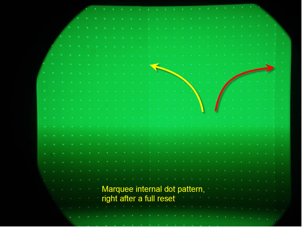

I saw an odd "rectangle of video noise" on another 8500 that (I think) turned out to be my Momitsu. So I turned off the Momitsu, did a full reset on the 8500, and maxed the Brightness setting. I could just see the left side of the noise in the internal dot pattern (8500raster2.jpg). The right side (red arrow) is different than what I saw on the Momi screen, but it shouldn't be there at all. The left side (yellow arrow) is in exactly the same spot as in the first picture.

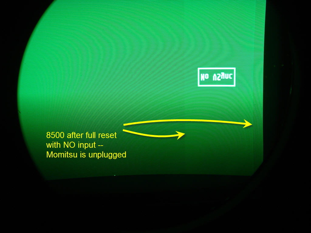

So then just to be sure (since the Momi puts out a sync signal even when it's turned off), I completely unplugged the DVD player from the 8500's inputs, and turned it on again. Now the noise is in a different place (due to different scan rates maybe?) but it's still there -- 8500raster3.jpg.
I tried pulling the contrast modulation (color correction) board, and that didn't change it.
Any guesses?
Thanks!
Gary

That looks like the residue from the video clamp pulse that is sent to the neck cards during horizontal retrace. Can you see it on the screen?

Just barely, in near-total blackouts. The Avia picture is misleading -- it's actually about 5 IRE, not 10. But I'd like to get rid of it if I could. Any suggestions?

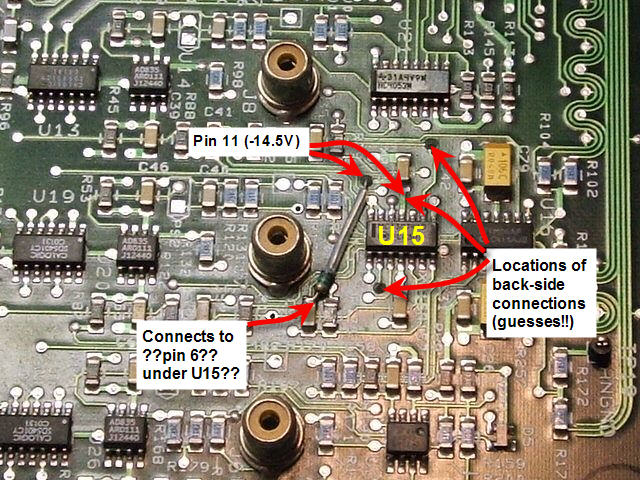

Hm. I'd have to compare the board to the pix to see exactly what to do, but it should be do-able. Hard to tell what's what from the pix. From the schematic it looks like you run the resistors from pins 2, 6, and 9 of U15 to -14.5V, which is handily available at pin 11 of U15. U15 seems to be the one just to the right of the component-side resistor. Putting the resistors all on the component side would be tricky -- pin 11 would get a mite crowded.
Would you check my picture and see if I've got it right so far?
I'm not sure this is the same problem, though. They describe it as a faint vertical line, not a rectangular area taking up a good part of the screen. Do you think it could be the same issue, Scott?

Posted: Tue May 15, 2007 11:51 am    Post subject:
Gary's pic:
I've got the same thing on mine. I knew it was a bulletin fix but never got around to finding the bulletin and fixing it. Maybe now it's time. Smile

Posted: Tue May 15, 2007 10:56 pm    Post subject:
Gary,
Your pic looks right. The line described in the ECO happens on the edge of the darker area after the video peaking mod is installed. I'm pretty sure that this change will lessen or eliminate the dark bar.

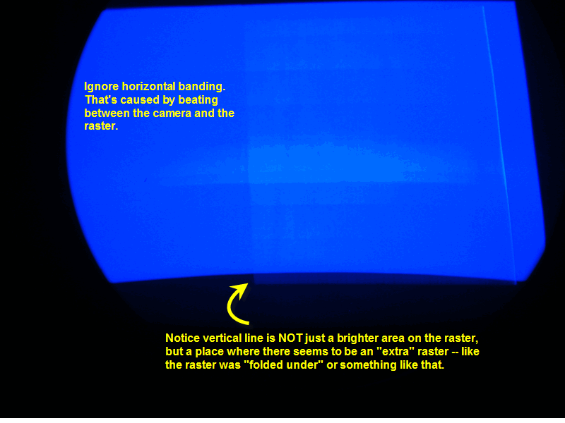

Posted: Mon May 21, 2007 4:06 am    Post subject:
Scott, before I tackle that ECO: take a look at the attached pic. I used the blue this time because it was more visible than the green.
Notice on the attached pic, the "noise box" is not just a brighter area on the raster. You can see that the box is almost like an EXTRA raster. I lost all my convergence settings when we cleaned the chips on my CLM, so the blue raster has some pincushion on it. But the "noise box" has a flat bottom, and its bottom sticks out below the bottom of the "real" raster!!
That's not the kind of thing the ECO is addressing, is it?
This is really not a fatal problem. I didn't even notice it until I realized I had the brightness set a few clicks too high on my **DVD player**. That elevated the black level coming out of the player and washed out the noise box. (And we just took a look at Dragan's pj yesterday, and noticed similar noise when we lowered the brightness on his TheaterTek player. So it may be a common problem?)
So if I had to, I have an easy way to make it go away. But I think I'd lose some deep shadow detail in the process and I'd rather not do that. I'd really rather get rid of this "extra raster." Any suggestions?

CZ Eddie
Joined: 23 Mar 2006
Posts: 1601
Location: Austin, TX
Posted: Mon May 21, 2007 4:21 am    Post subject:
garyfritz wrote:
Hey, it turns out this ECO is on Curt's site already: http://www.curtpalme.com/docs/ElectrohomeMarqueeTechnicalBulletin_LineFix.pdf
I've seen the issue mentioned in this bulletin posted above. It's definately *not* the issue you have started this thread about. Sad

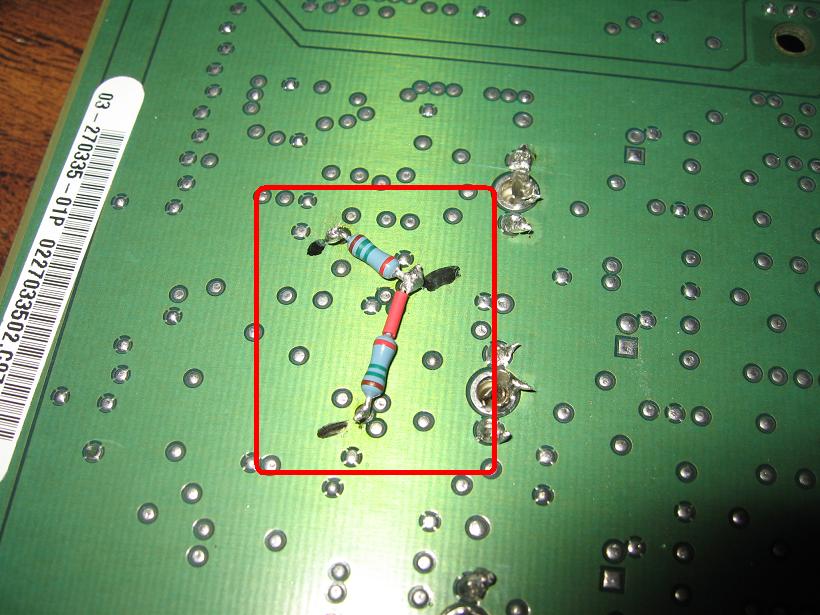

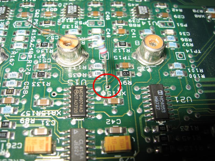

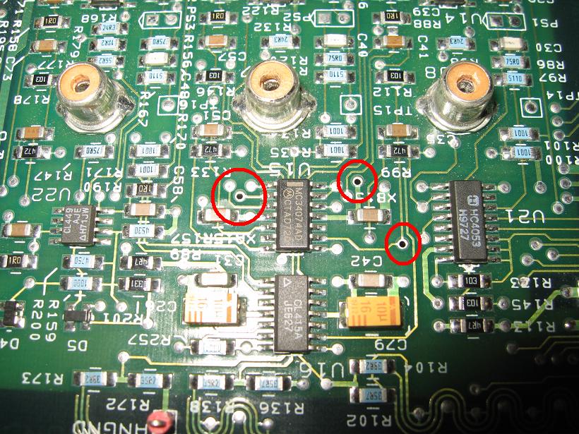

Posted: Tue Jul 17, 2007 11:28 pm    Post subject:

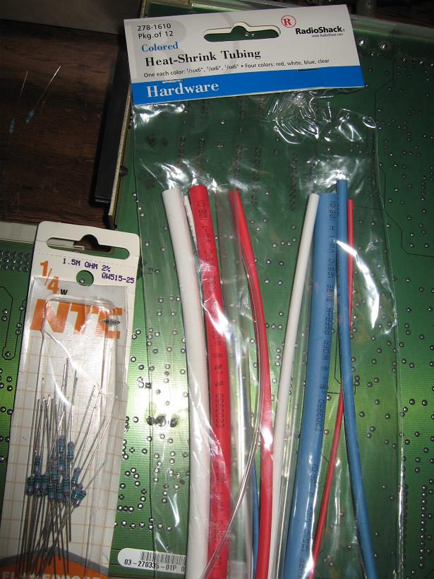

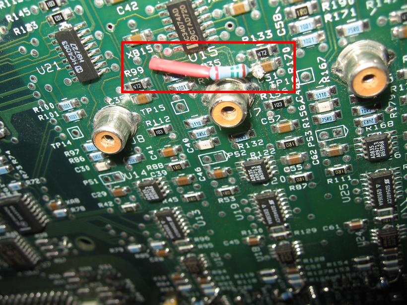

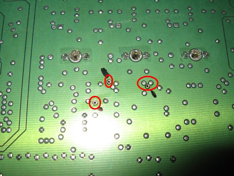

FYI: The TB95-10 for "Folded Image" didn't do anything for me. I just performed that mod (very easy to do, one diode only) and didn't notice any difference.
Also, we can rule out the VIM & VNB's because I removed mine and put some older 8500 boards in mine. And I still have the same artifact shown in your pics above.
I was sure it was the Folded Image TB because thats almost what it looks like. So now I'm going to see if I can find the parts for the Line Mod to see if that does it afterall.
Edit. I do have the parts, but it calls for 1.5M 1/8 watt and I only have 1.5M 1/4 watt. So I'll try these out. I'll use shrink tubing to get it done.
CZ Eddie
Joined: 23 Mar 2006
Posts: 1601
Posted: Wed Jul 18, 2007 12:59 am    Post subject:
Gary, good news!!
The artifact is not "gone", but it is drastically reduced!! I can really only notice it if I set my brightness "too high".
And the line is 95% gone also!
Perhaps it might have all gone away 100% (not likely) if I were a better solderer, or if I'd been able to locate the solder I'm using to working with. The stuff I'm using today (ratshack .052 60/40) doesn't work that great. It's kind of "runny". Which is good for filling in holes but it also goes everywhere else!!!!
Don't worry about the black marks you see in the picture. That was me marking my spots with a black permanent ink marker.
All the parts in the first pic are what I needed. I pulled the resistors out of an old stash I picked up at Fry's. The tubing came from Radio Shack. I'm sure either place has both items. Though Fry's would be my first stop due to Ratshack pulling out of the bitty components business these days.
