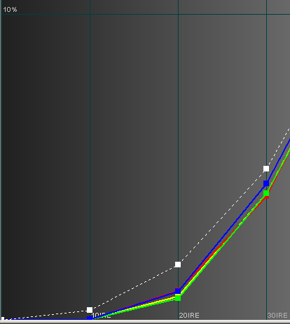

But even with the gamma boost maxed, the low IREs are still lower than they should be. I just re-measured last night with HCFR, a free calibration software tool that (together with a Spyder2 sensor) is more sensitive in low IREs than my old Minolta colorimeter. 8500HCFR.gif shows those results, zoomed in on the low IREs. IRE10 and 20 are 1/3 to 1/2 what they should be, even with Kim's box set to maximum boost. So the dark shadow details are still getting lost. And that's just compared to gamma=2.5. I'd like to at least try a smaller gamma (== higher low-IRE levels), bringing out the shadow details a bit more, but I can't even reach 2.5.

I think those pictures are with "black compensation" at ON setting (because the graph is flat at low end), which makes lowest measurement to IRE 0 when it's in reality above IRE 0.
IMHO: black compensation is for digital PJ/displays only.
Sensor -> Configure -> Calibration -> Options -> unselect Black compensation. That should make gamma chart look little different at low IRE immediately, without measuring again.

Hm. I thought Black Compensation was only for things that looked at / analyzed the curve, e.g. if it tried to estimate the gamma. You think it actually changes the way HCFR *reads* the low IREs?
It doesn't effect way how HCFR read. But it affect how HCFR calculate low end gamma. Try it, you'll see...

Posted: Wed May 09, 2007 10:04 pm    Post subject:
If it only affects how HCFR calculates low-end gamma, that's not going to change what I'm looking at. Look at the 3rd picture in my original post -- the measured levels are way low.

OK, I tried setting the G2 the way you said, and it was only a few clicks off of where I had it set already.
However I did notice something else: I forgot there was a brightness control on my DVD player, and it was a few clicks too high. I set that properly, and then my low-IRE levels looked much better. IRE 10 was still way low, but 20 and 30 were almost right. But remember I have my Kimcoder gamma boost on max... it wouldn't look so nice without that.
