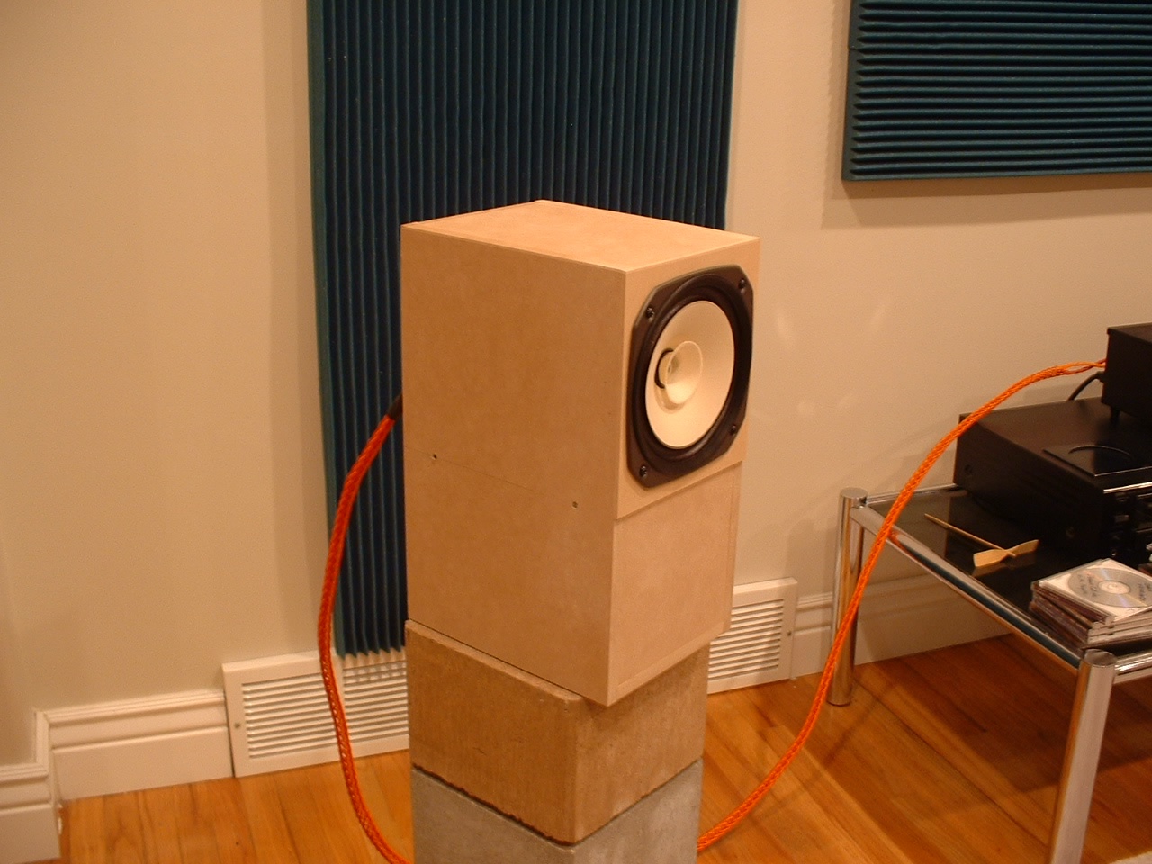

Right now I am doing a really tweaky approach - I have 3 Fostex FE166s in small boxes driven by a 5-channel gainclone (30W/ch) for my LCR speaks. The Fostex is a "full range" speaker driver, a 6.5" paper cone with a "whizzer" cone for high freqs. Quite high efficiency, for an 8 Ohm driver, it's something like 93~94 dB @ 2.83V. They will peel the paint with 30 Watts behind them. Not the most refined sounding speakers (they have a lot of simple harmonic distortion), but they are excellent with dialog, very natural sounding with voice. I had to design a custom eq network (a passive RC filter) ahead of the amp to do some response shaping, because the raw response was, well, too raw. End result is very good, though.
And cheap! The drivers were $65 each, and box cost me about $40 each. And they are unique and people think they are cool.

Posted: Sat Mar 24, 2007 6:09 pm    Post subject:
Here is a pic of one of my Fostex FE166s in a simple closed box.
