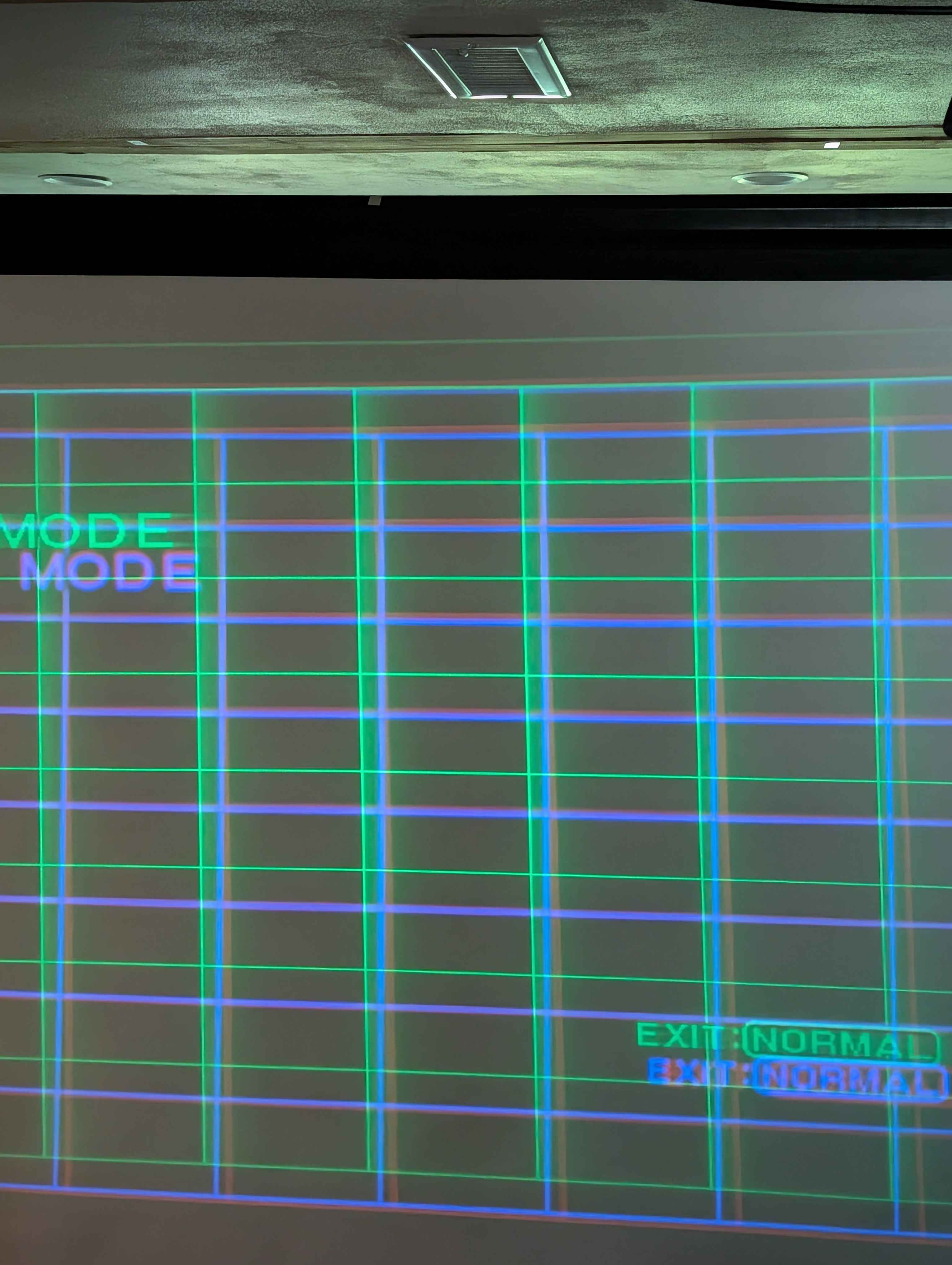

First time poster here let me know if I did anything wrong. I picked up a sony g90 along with spare tubes but ive run into an issue where the green bleeds / smears and if the contrast is too high (by this I dont mean im cranking contrast to max I mean even at like 50% or something) or the scan rate of the input signal is too high theres some black flickery stuff going on the screen, if anyone has some idea whats going on and how to fix it please let me know, the issue only happens with the green the red and blue are perfect, I can try and get a picture or maybe video of the black stuff tomorrow its just been discouraging so I havent touched the projector in quite a while so this is an old picture ive attached. [/img]
ignore convergence/geometry just showing the green color bleed

alright update, its not really black flickery stuff I remembered wrong I guess more like the bleed of the green kind of flickers a bit darker constantly and the spot it does that is constantly changing kind of like tv static

Haven't seen that before on a G90, but it's three things: (most likely)
-bad YA board
-bad video amplifier, the board sitting on top of the green CRT neck. Swap it with one of the other ones, to see if the problem moves to another tube.
-bad CRT.

alright I swapped the amp board for green and blue and the issue moved to the blue tube, will look into getting the board fixed soon, if anyone has a spare to sell or can fix it in wa let me know
