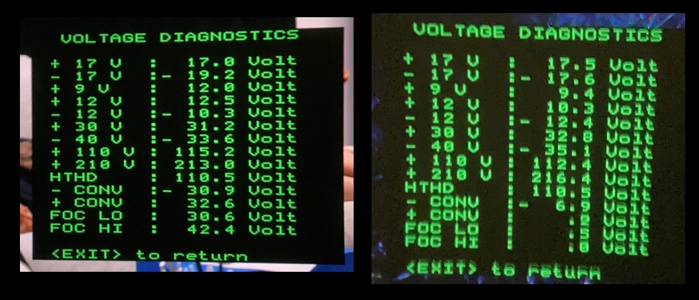

I have a pair of DTV-1200 (Cine9) projectors that are still working well with no errors. The second unit recently changed its bottom 4 values on the voltage diagnostics screen to very low numbers, so I'm wondering if anyone knows what board those values represent. It's probably the SMPS but thought I'd ask here before I start pulling boards. Only found this as I check the voltage diagnostics screens every month or so to see if anything has changed.
