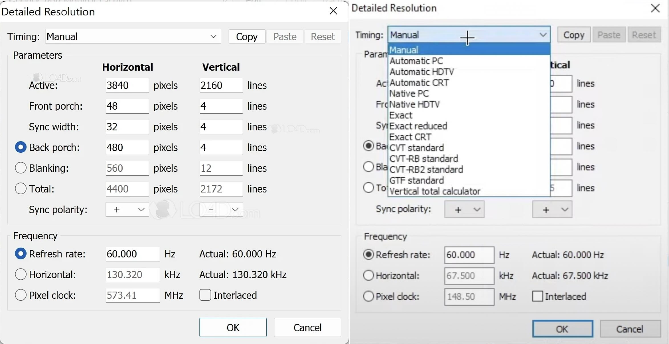

I have been setting up my Sony G90 recently and now that I have a PC with a GPU I can output custom resolutions and projectors to the projector. I want to start using 72hz progressive and 96hz interlaced for movies.
I tried using CRU (Custom Resolution Utility) at 1920x1080p at 72hz and just used "Automatic HDTV Timing" and that resulted in a raster going off to the side of the tube and not being able to correct that with the centering controls, so I quickly reverted back to 60hz. How should I set my output settings to avoid this?
 Filename:  CRU Settings.jpg
 Filesize:  238.67 KB
 Downloaded:  15 Time(s)

I know about PowerStrip, I can already output custom porch settings, however I don't know what values I should select.
I would really like to know the timing settings for 1920x817p 72hz and 1920x817i 96hz.
