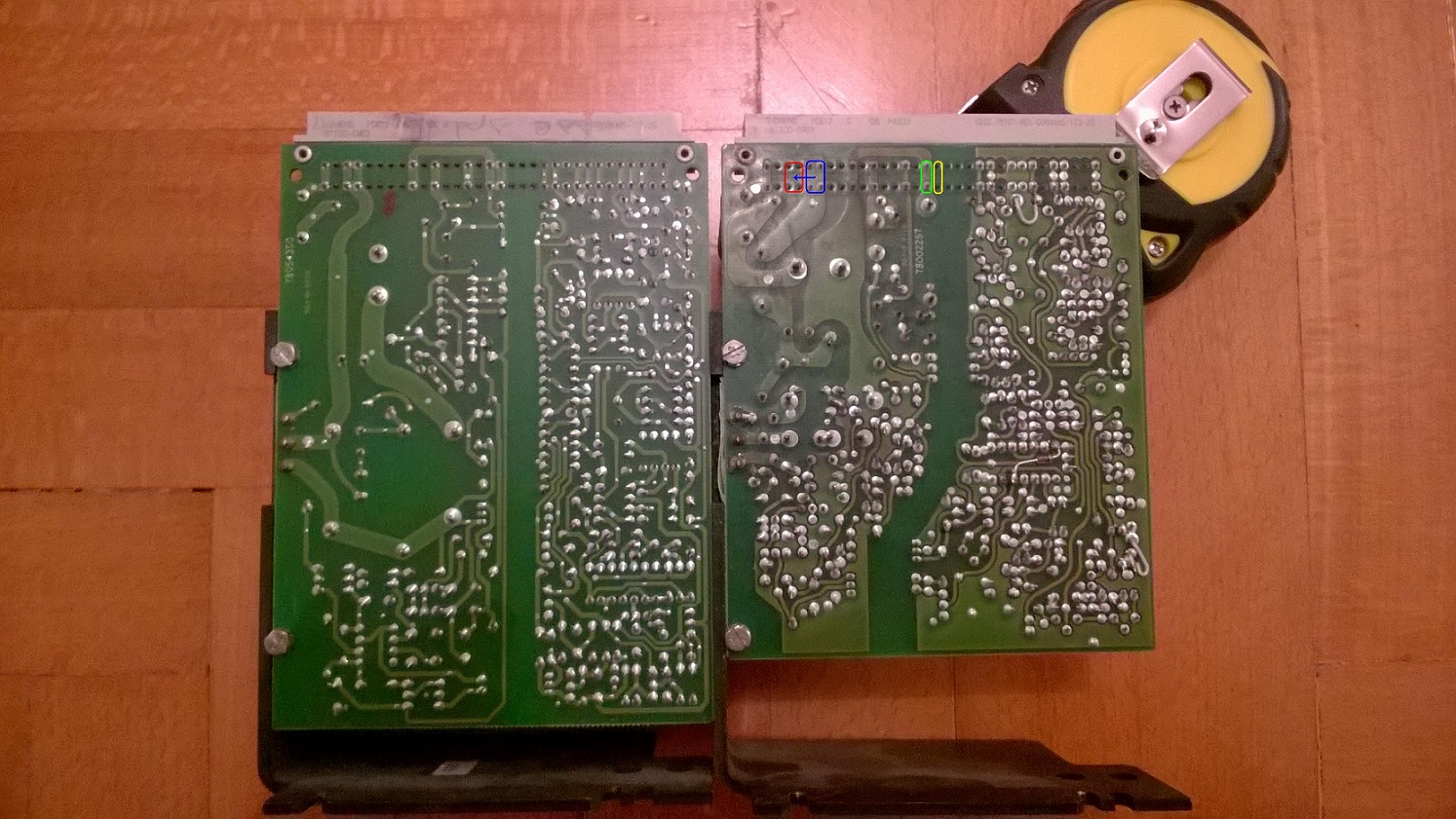

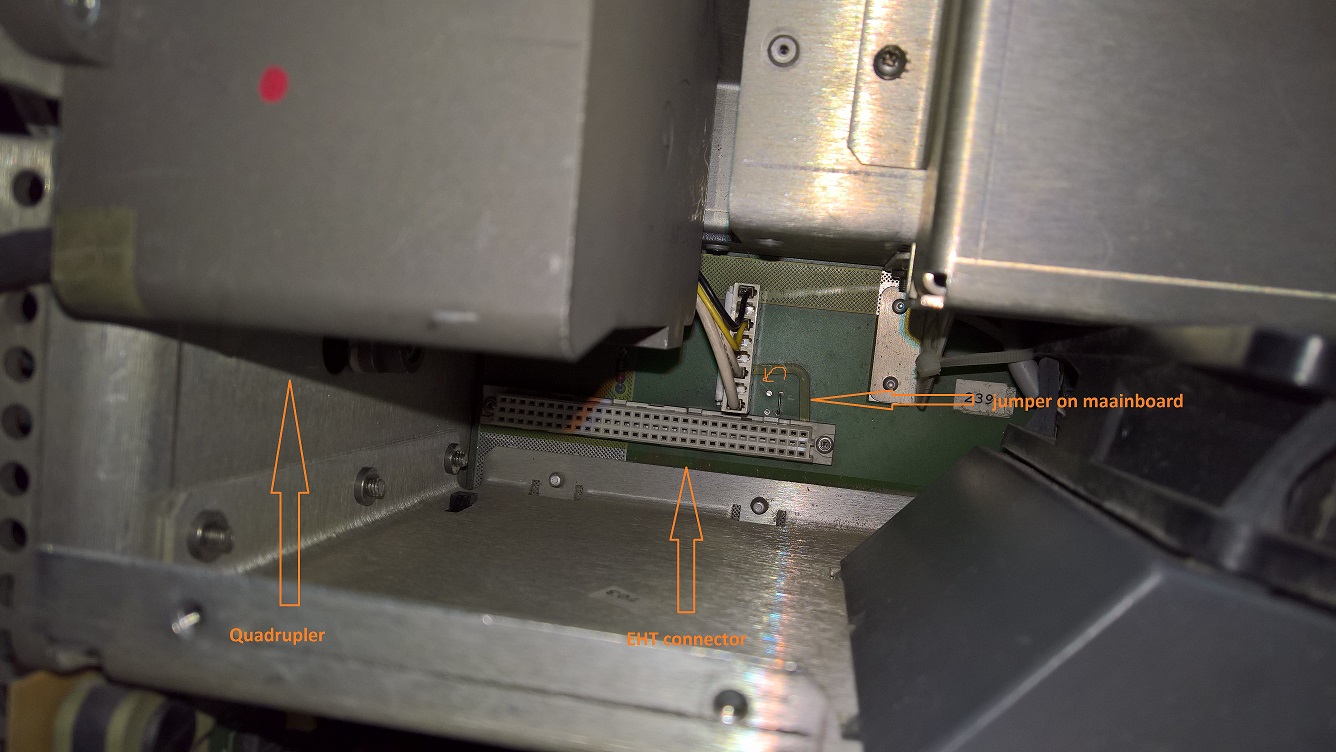

alb_qwerti
Joined: 30 Sep 2008
Posts: 54
Location: Italy
Posted: Tue Jan 02, 2024 1:40 pm    Post subject:
Hi guys,
Sorry for the late answer but very busy these days.
In the first instance Happy New Year to everyboddy!
I know that service bulletin. For working an old quadrupler and old EHT on a new frame you should replace the bridge on the main board.
To desolder it you must remove the cover and it's impossible with the PJ hanged on the ceiling.
Otherwise you could jumper the old EHT.
Anyway I was pointing out that with all new parts a very old quadrupler from my BG800 made no oscillations on the 1209/sE.
For years, until the last month.
I thought that it was the same R761743 but maybe it is different.
And finally I'm still not sure that the issue was the quadrupler because the image appeared again only after changing the splitter.
Thanks,
Alberto
 Filesize:  487.78 KB
 Viewed:  2374 Time(s)
 Filesize:  307.2 KB

virusc
Joined: 11 Apr 2007
Posts: 358
Location: Massachusetts
Posted: Tue Jan 02, 2024 2:49 pm    Post subject:
Thanks for the pictures. That is helpful. hopefully this stays on the forum for a long time for others.

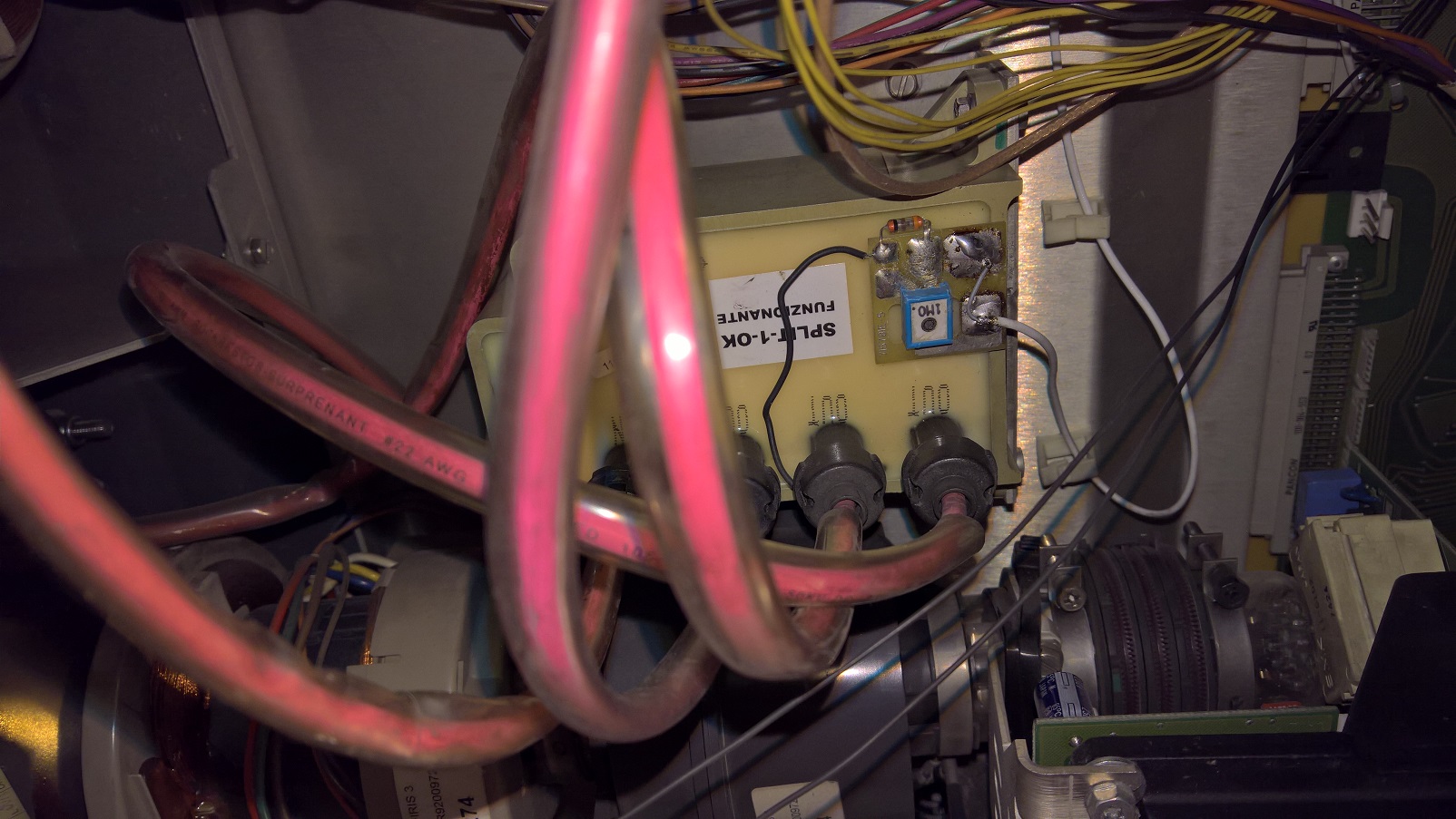

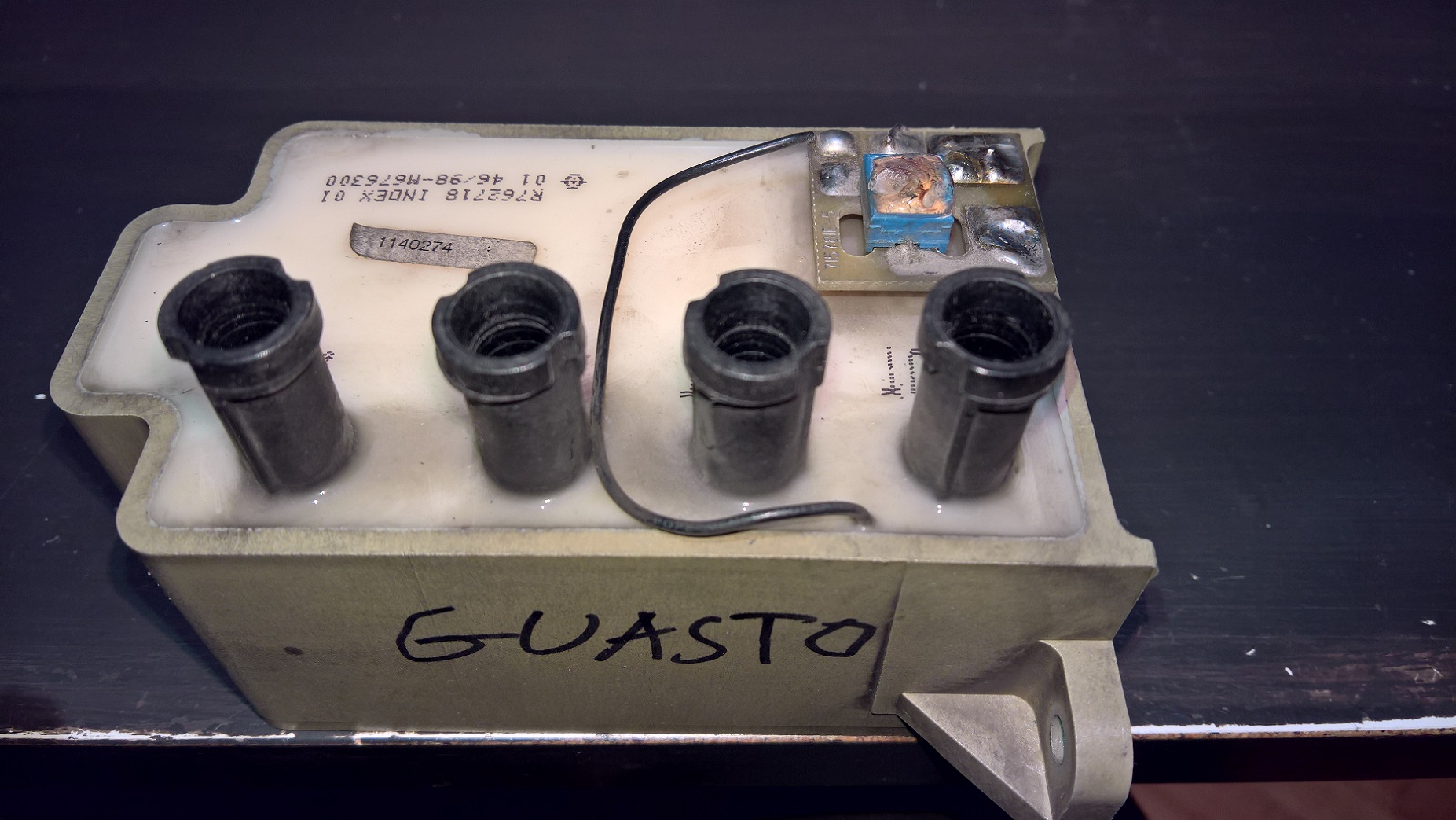

alb_qwerti
Joined: 30 Sep 2008
Posts: 54
Location: Italy
Posted: Tue Jan 02, 2024 6:38 pm    Post subject:
Is it possible that in my old splitter the only issue is that melted part over the circuit that I don't know what is it ?
Thanks for your help.
 Filesize:  489.54 KB
 Viewed:  2347 Time(s)

Posted: Tue Jan 02, 2024 8:30 pm    Post subject:
Wow, that is roasted. Don't use it anymore, it will take down the EHT board or (and) the quad.
The splitter should receive 33,7KV from the quad. That mini-board on the splitter have a 1MOhm resistor on it, and the blue potentiometer is factory adjusted for a 1/1000 divider. The white coax cable gives feedback to the EHT, reporting the voltage present on the splitter. So if that pot is damaged, the feedback voltage is not accurate anymore.
There are two ways to check the right voltage into into the splitter. Measuring with a precision multimeter onto the soldering point where the core of the white feedback cable is soldered, or using a HV probe connected to one of the three "OUT" connectors on the splitter. Both should read 33,4V (a HV probe has also a 1/1000 divide resistor on it, so the real voltage would be 33,4KV).
Anyway, don't mess with second option if you are not familiar with high voltage work. Just try another splitter.
