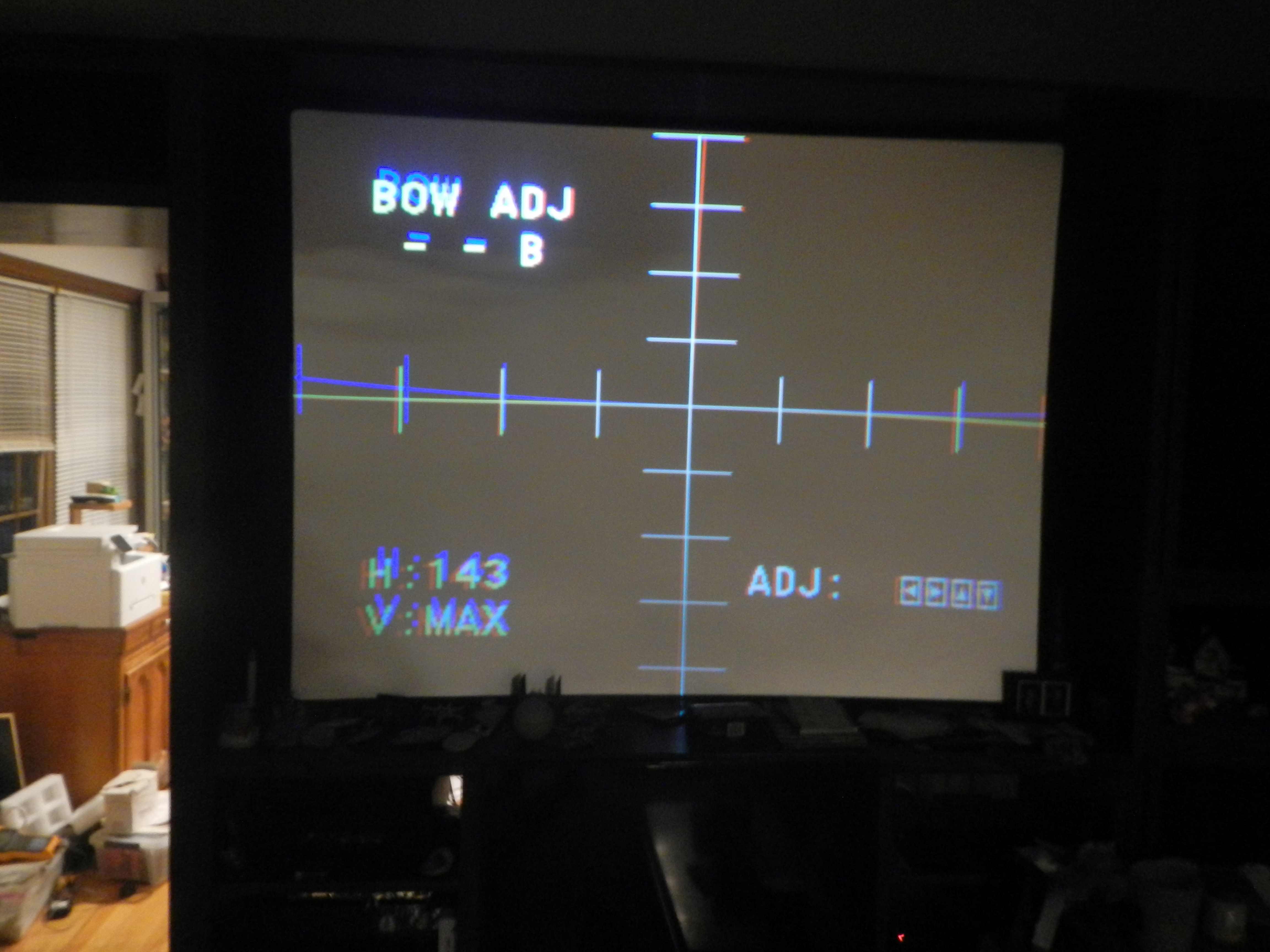

Trying to adjust convergence on my Sony 1292. I am using a Vutec curved screen. When trying to converge I cannot get the blue bow to adjust the numbers on the screen change but the blue line does not move . Any thoughts would be appreciated.
Posted: Mon Nov 13, 2023 10:48 pm    Post subject:
It looks like the convergence / deflection circuit for blue has a problem, only bow does not working, everything else is?
A picture would tell 1000 words. How bad it looks?

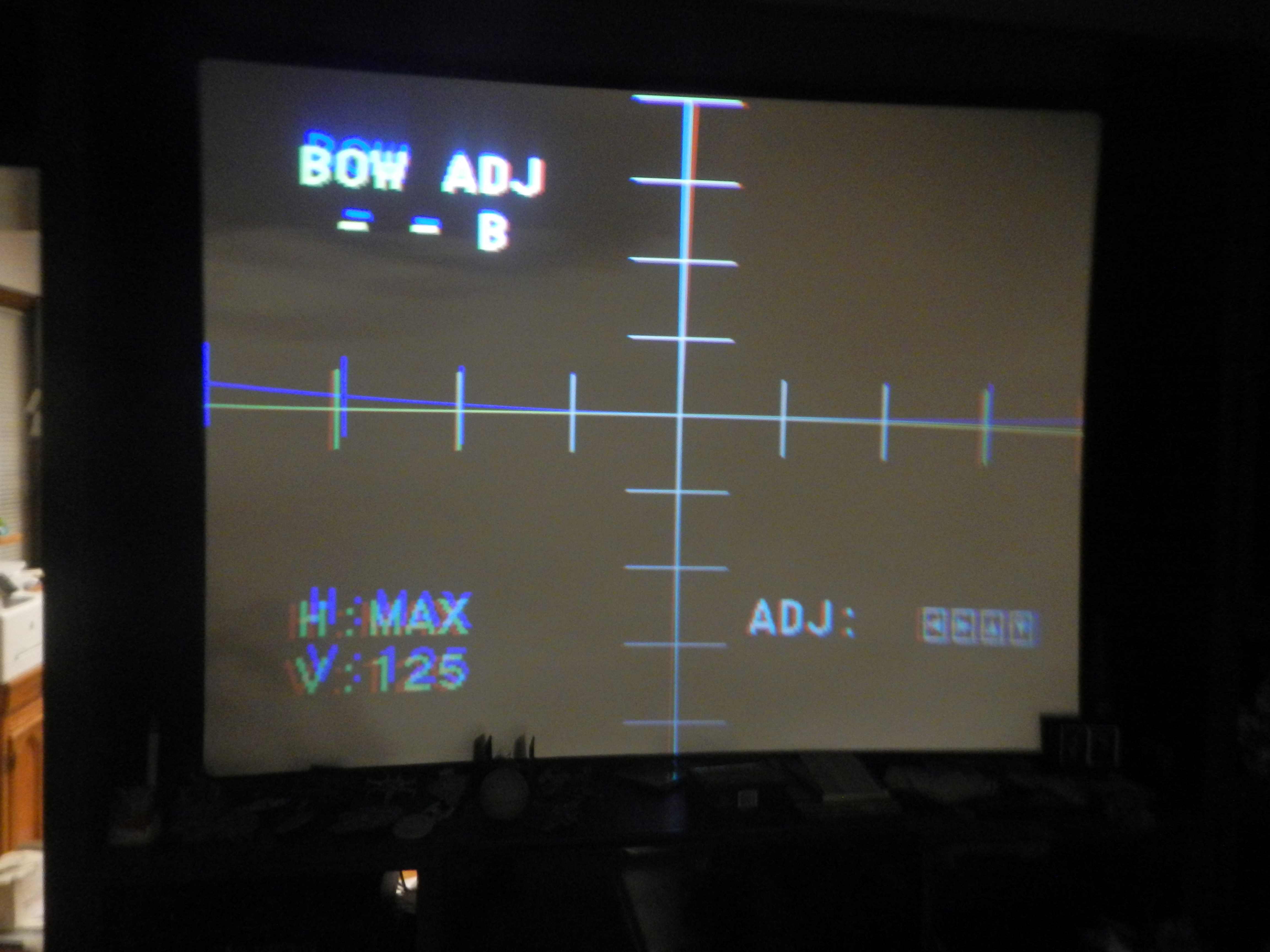

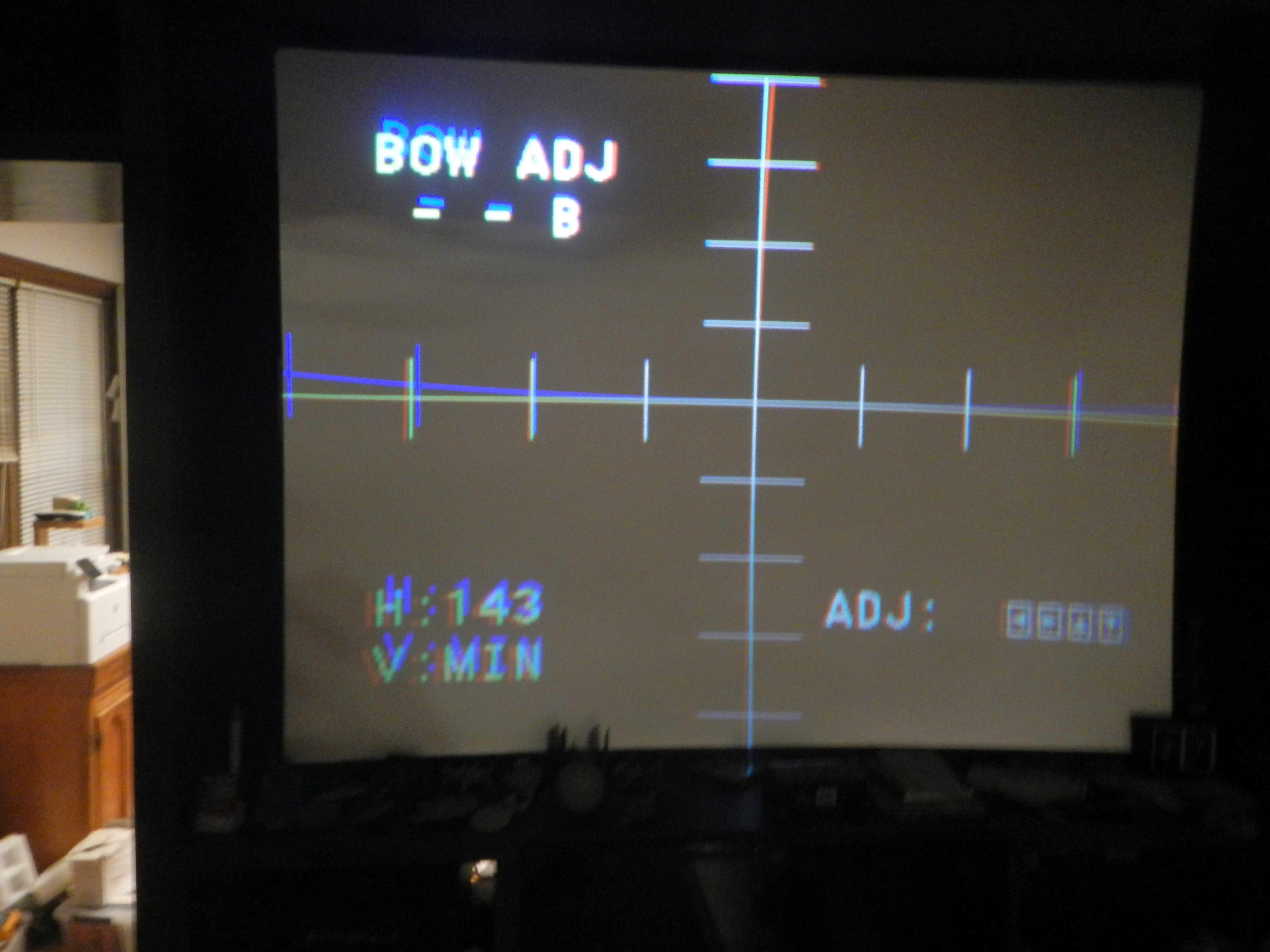

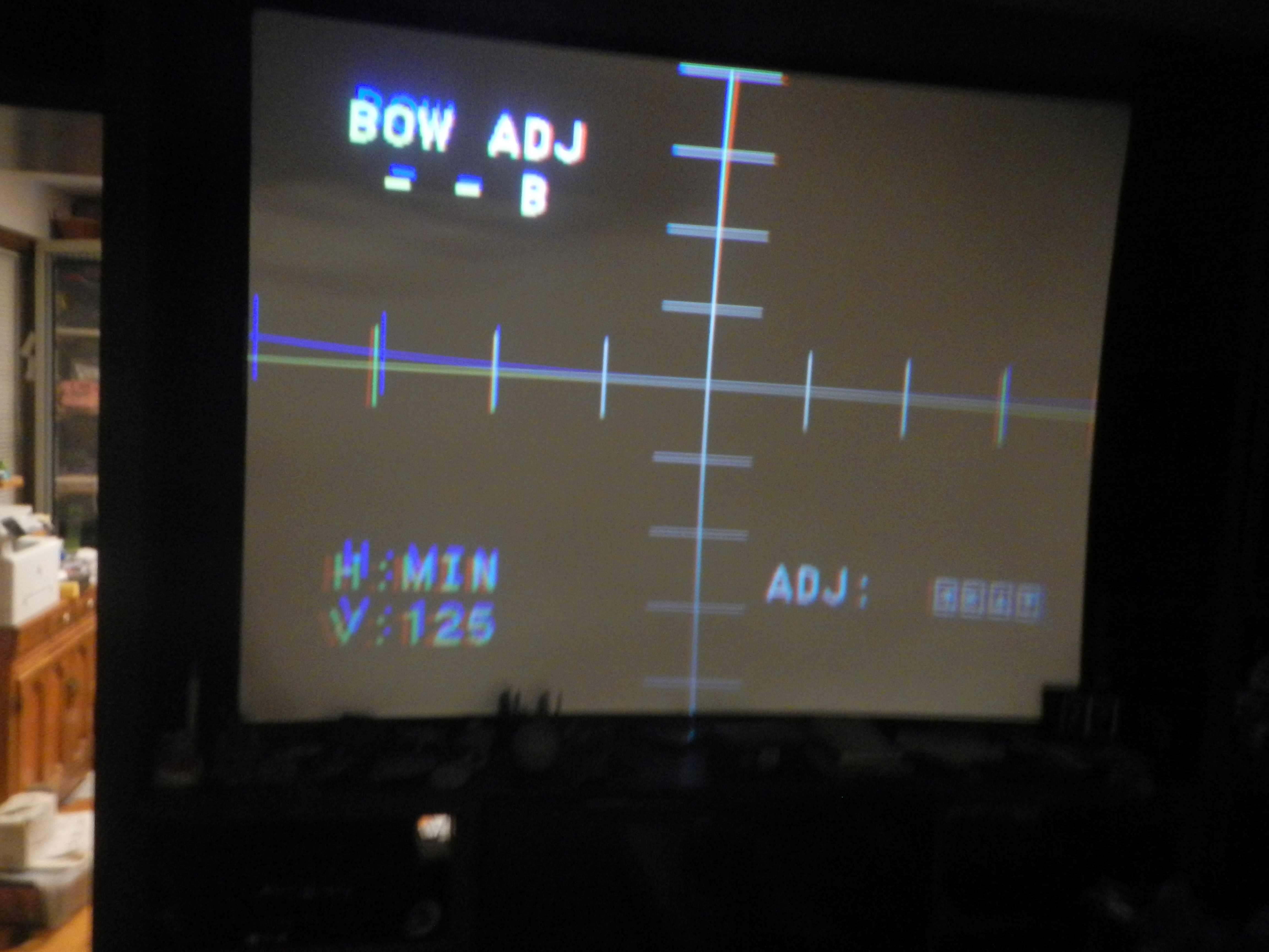

I am posting the pictures as can be seen I adjusted the blue bow to the min and max for both H and V the pictures show that the blue line does not change

I just reseated the DCC and DCA boards that are on the DC board I was able to adjust the blue BOW the red vertical now does not adjust Does anyone know which of these boards adjust the red blue and green?
Posted: Wed Nov 22, 2023 1:21 pm    Post subject:
The source of the correction signal is the DB board, the signal goes through the motherboard (DM).
As for the DCA boards on the DC board, CN210/213 belongs to Red, CN211/214 Green, CN212/215 Blue. DCA boards are interchangeable

Found the problem a plug on the DC board was not seated. Plugged it in and was able to complete convergence. I have another 1292 that is showing a 02 fault would you happen to know what on the DC or E boards would cause this fault I know that it is one of these two boards because I had this fault on the projector I am using now and when I replaced the boards the fault went away.
