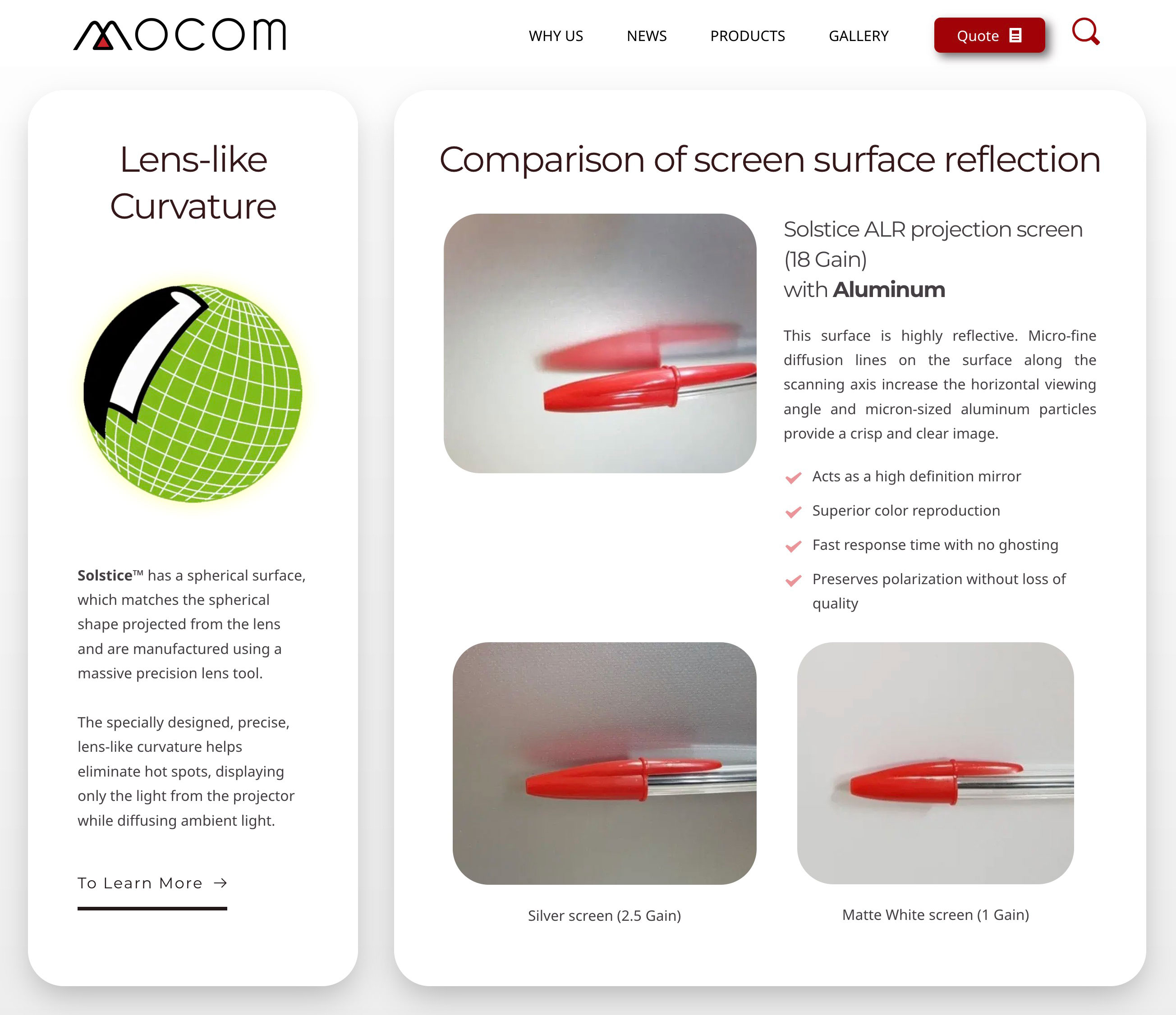

Wow, thanks for the link and response.
Looks like they have a patented 18 gain screen here made with aluminum.
(As a hobbyist consumer, I am scared to ask for a quote lol.)
Ultra High Gain Aluminum Screen

Trust me, you don't want an 18-gain screen. Even the 7 is going to be almost unusable. With gain that high, the screen is almost a mirror. Unless you have absolutely perfect parabolic shape on the mirror, you will have unwatchable hot spots. And if you have the perfect shape, you will have to practically clamp your head in place. Move your head more than an inch or two off the perfect spot, and the brightness will drop off dramatically. AR liked his 7-gain screens, but be aware of the limitations.

Yep.
They have a video about this 18 gain screen here that kinda misses the point in many ways and makes many illogical statements:
https://mocomscreens.com/products/alr-projection-screen-solstice/#lBl7gye3pNlz
Trying to push their high grain the first question they ask in the video is: "Why do people think projection screens are for dark places?".
Well, the answer is because it's impossible to do the colour black unless the room is dark. Turn off the projector and look at the screen (any screen including theirs) in that brightly lit room. That's your black. Not great is it? You can't "fake" black by simply increasing the contrast ratio through gain.
IMHO if you must have a bright viewing area and want the best image quality, get a direct view display (TV) with a non-glossy surface. That TV will actually look black.
There's a reason why HT enthusiasts today won't use really high gain screens where image quality is paramount.
