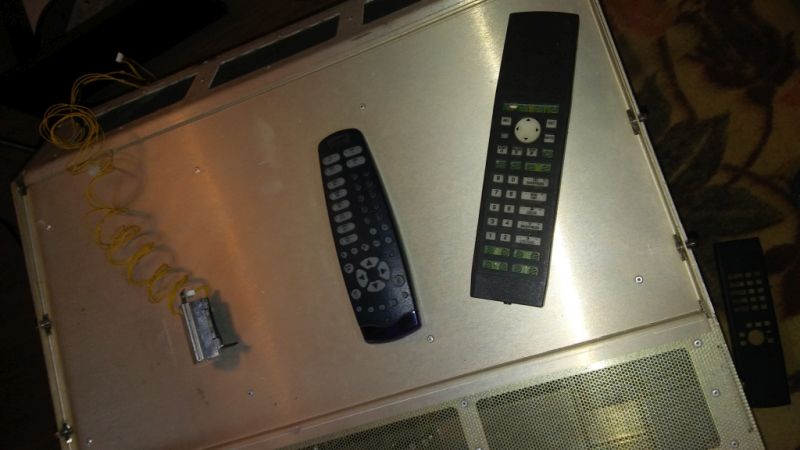

I have a Barco 908 retroblock. Only one new remote control is attached to the housing. I have a second 808 retroblock projector that has an old type wireless remote control. I have a wireless control sensor for 908, but I don't have a wireless remote control. The old wireless remote does not work with the 908. What can I do? What should I remove from 808 to 908, what should I do to run the old type of wireless remote to work with 908? Can this be done? The new type of remote control 908 screwed to the housing can not work wirelessly. Soft 908 - 2,22 ,soft 808s 7,22

Those remotes work on two different systems. I know you can get the 908 remote to work on an 808 with the right firmware, RWI version and the sensors from a 909 but I doubt the reverse could work. You need to to obtain a remote from a 909 that looks just like the one embeded in the retroblock.

Not good. Will it work from cine 7?

The remote that is fixed in the unit will also operate the projector.

Is it technically possible to re-make this remote control from the housing? Is it possible to solder the system, give it energy - a battery for wireless operation?
I don't believe so although I have not seen a Cine 7 remote. The Cine series projectors are not the same. The Cine 7 and 8 are nothing like a Cine 9.
Posted: Tue Nov 26, 2019 8:56 am    Post subject:
They are completely different systems. If you have a Cine 9 you need Cine 9 or 909 or 919 gear including the remote.
Posted: Tue Nov 26, 2019 8:58 am    Post subject:
Put a WTB in the buy sell forum for a 909 or Cine 9 remote. You just might get one for not much money. You have nothing to lose by trying.

Well. Thank you for the information. For now, I will extend the cables and fix the remote control elsewhere. Then I will look for a wireless remote control and buy it

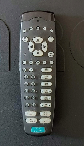

This looks identical to the imbedded remote

and it looks like cine 7. They all look the same but may or may not work. It is best if it is certain that Barco 909. For now I have extended the cables and that's how I work. I will buy the remote control at the end when I start and set up the projector. I replace the lenses and the "C" element. I threw out HD 117/12, I chose colorful glasses and Sony G70 lenses. I don't like this job, hideous glycol. Confused

Its certainly looks the part

I think a Cine7 remote control will work in your 908.

I borrow a cine 7 remote control from a friend and check. How it works, I'll try to teach a universal remote control
