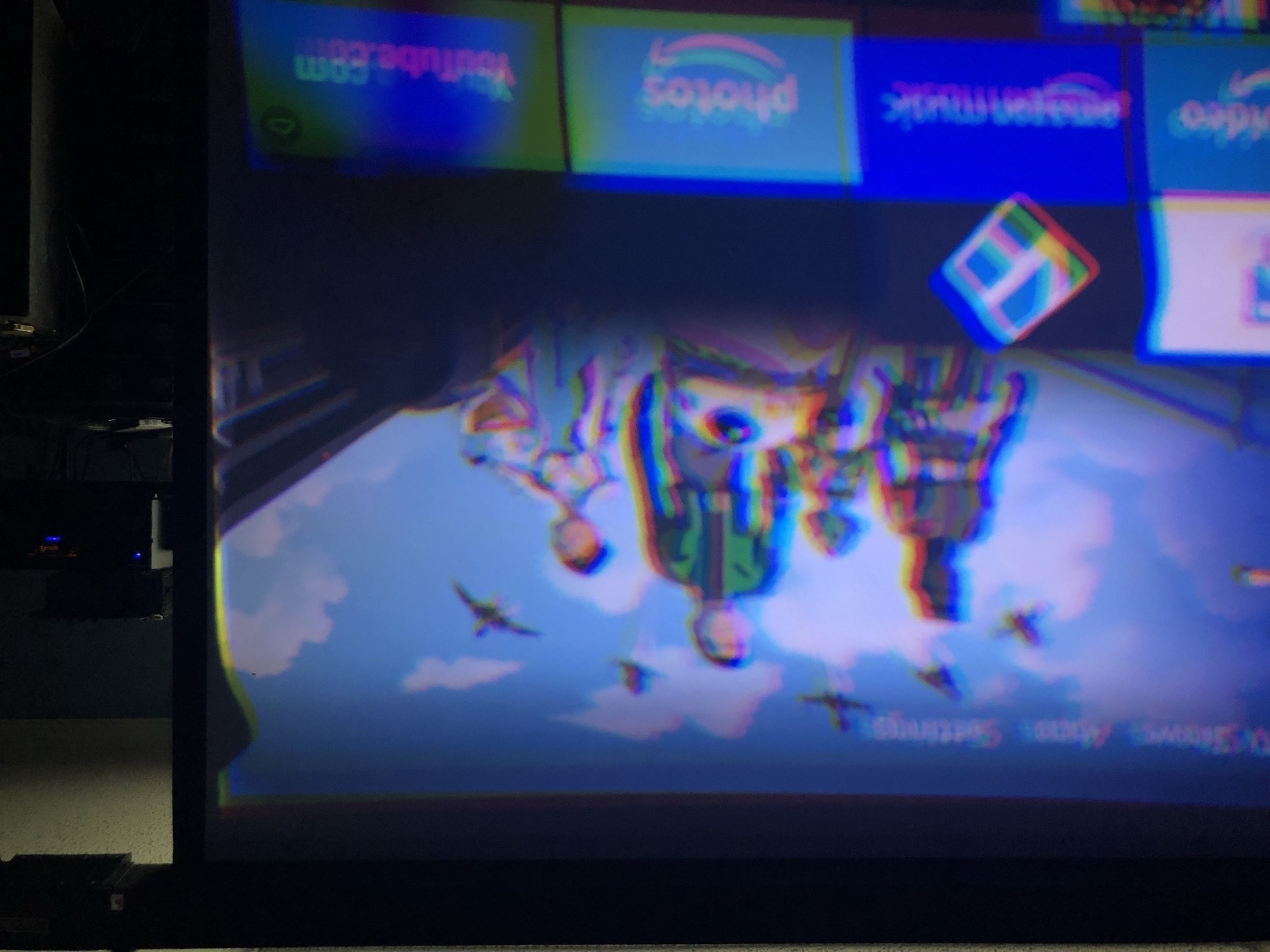

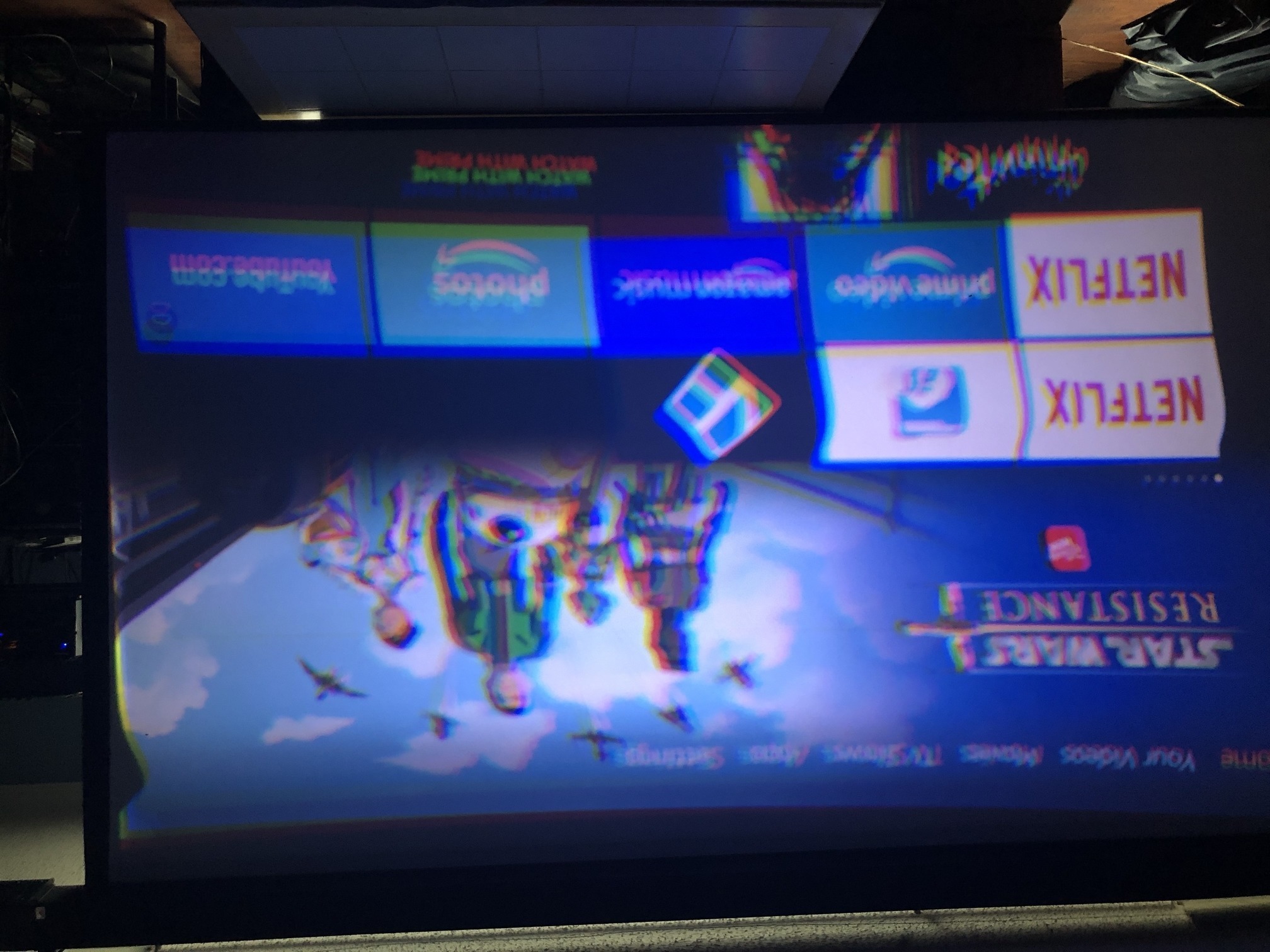

With that being said I now have a problem that I need an idea what board is the problem. I went in the kitchen and while i was in there I smelled the familiar smell of burnt electronics. I cam back in and convergence is all screwed and none of the adjustment buttons do anything. The remote shows that they are changing numbers up and down but nothing happens on the scree. I have almost every board for it but I think one. SO where should I look first for the burnt board?

Boards that use a lot of current are more likely to burn up a resistor so pull boards like the horizontal deflection and convergence to start, and the power section, and look for charred things.
Posted: Sun Nov 11, 2018 4:26 pm    Post subject:
Change the convergence board and convergence output board. Looks like you have enough spare parts, which is good, as I've thrown out all my Ampro stuff a couple of years ago.

So far I have pulled and inspected all the convergence boards. I have yet to see a single thing that looks heated on any of them. Tomorrow I will drag out the spare PJ and start swapping boards.
I also noticed that the image looked wrapped and when I tried to adjust the blanking it done absolutely nothing. Not sure if that is controlled on the same boards

An overload on the power supply can do that. Start by pulling the convergence output board, and turn the set on. you should be totally unconverged (obviously) but the smell should be gone. Same with the warping of the image.

Finally getting back to this. I have changed the Horizontal output and the Convergence output boards. No changes. It has not had any burning smell since it first happened. If it did i could find where it was coming from. But I decided to try and reconverge it. I went into the menus and started adjusting and it all moves but when It asked to adjust the blanking I get nothing. None of the blanking works in any direction.
