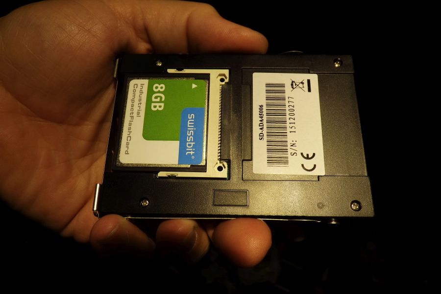

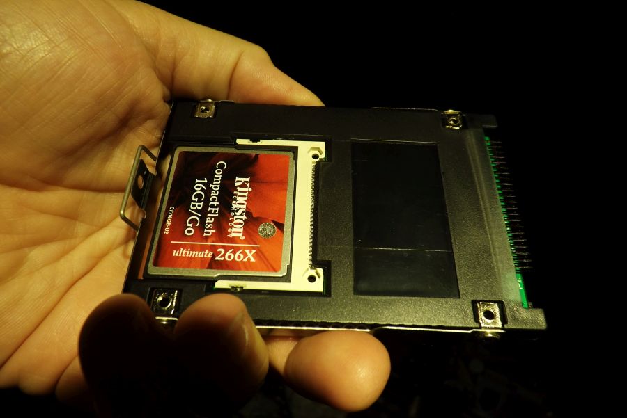

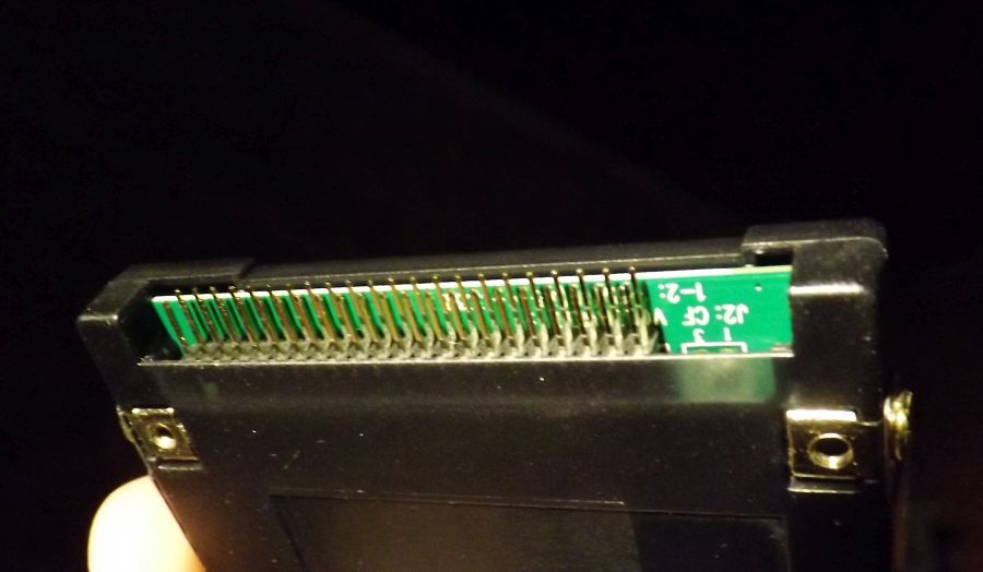

I've ordered a CF to 44 pin IDE adaptor for this and an 8GB CF card. This is going to be fun.
It's here! This one holds two CF cards. So far the computer won't see the 2nd CF card under FreeDOS. Could be the laptop BIOS won't see a seond drive. They didn't have a single CF card adptor that had the screw mounts in the right place so I bought this on. So ar so good. FreeDOS sees all 8gb of the card. Boots damned fast too.
Now to install some games!
FYI: if you want to do this you'll need INDUSTRIAL CF cards. They are the bootable ones.
