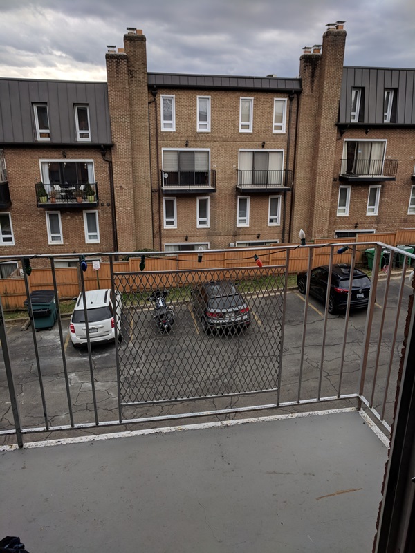

Balcony looks like this. The easiest way to mount seems to be on the lattice.
You can see the other complex directly across.

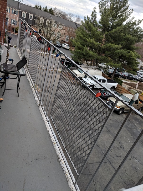

Pic #2

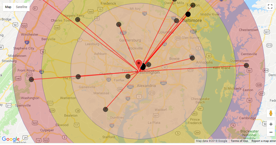

This is the antenna range from where we are. The balcony faces south or southeast.

Antenna reception is a fun experimental thing. I tried 20-30 antennas back in 2008-2009 to see what was best for where I am. Some of the small ones are pretty decent. What's the small model you picked up?
Looks like all the stations except one are north of you. Too bad, BUT again, try bouncing the signal off the building infront of you. Experiment.
