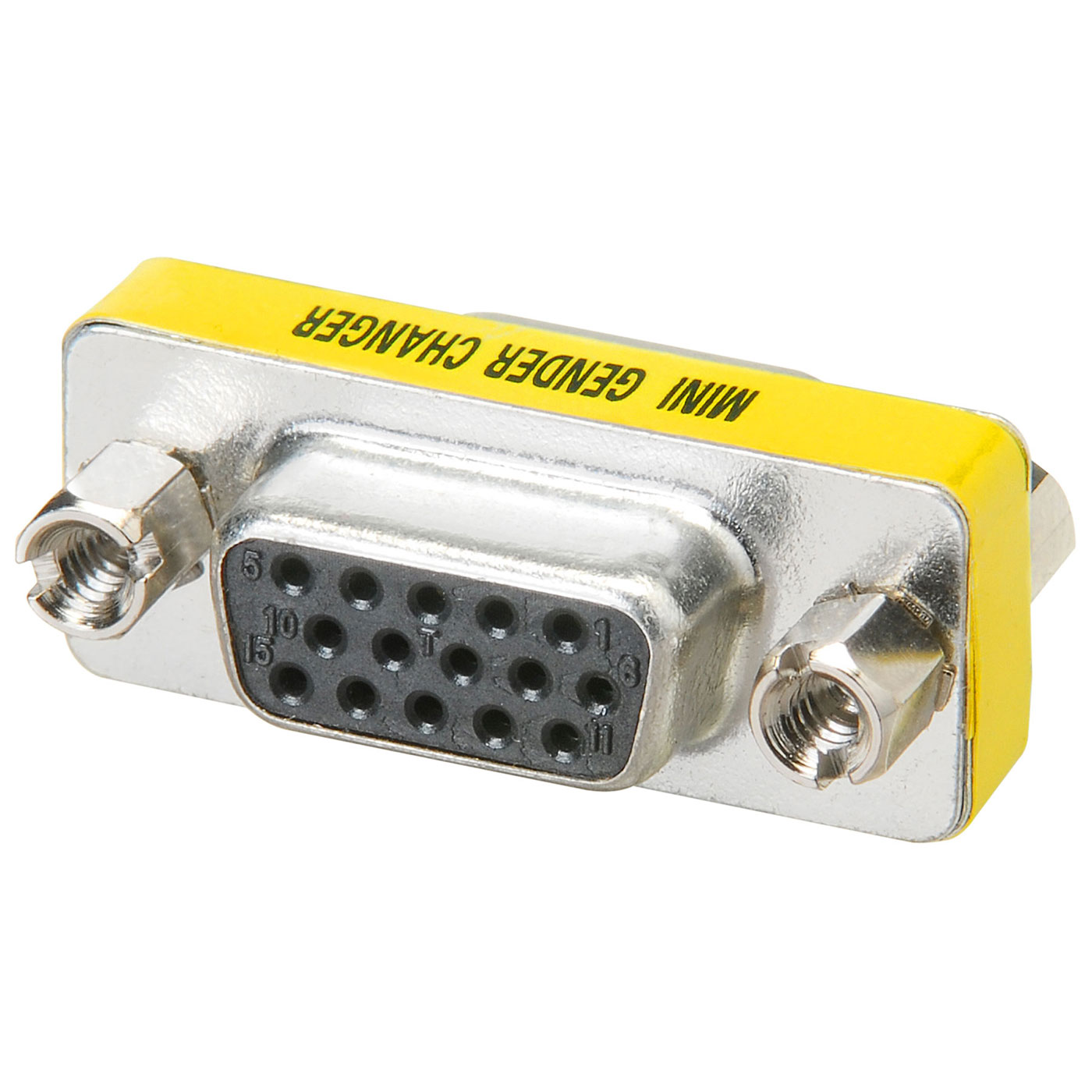

Also if using an HDFury1 you wil need a 15 pin F to F VGA coupler to plug the HDFury1 into the VGA cable.
Plug the HDFury into the VGA cable input on the Extron, set EXtron to negative sync for H and V. Go 5 BNC to projector. Then shift the picture to the right using the controls on the Extron box.

So one of those with a F/F HD15 gender changer and an HDFury 1 or 2 would work on the Barco. Excelent!
