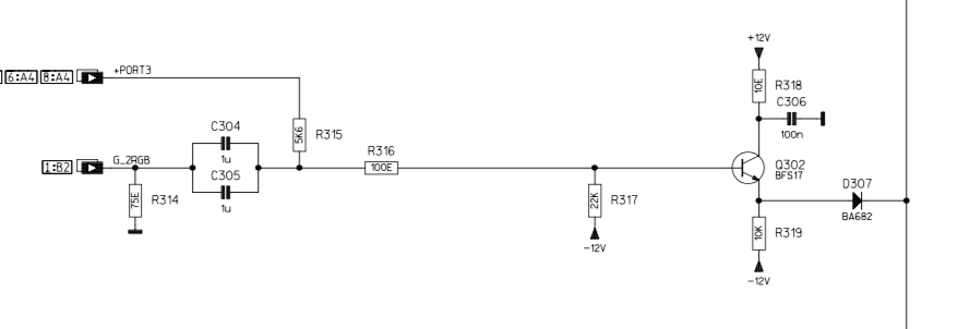

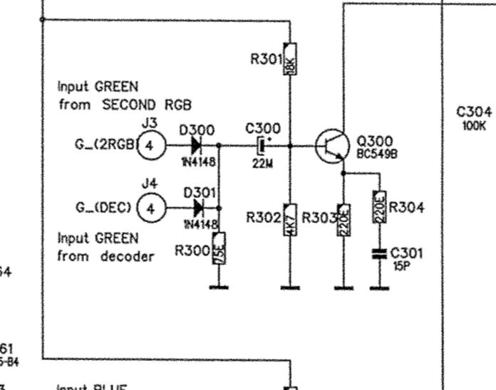

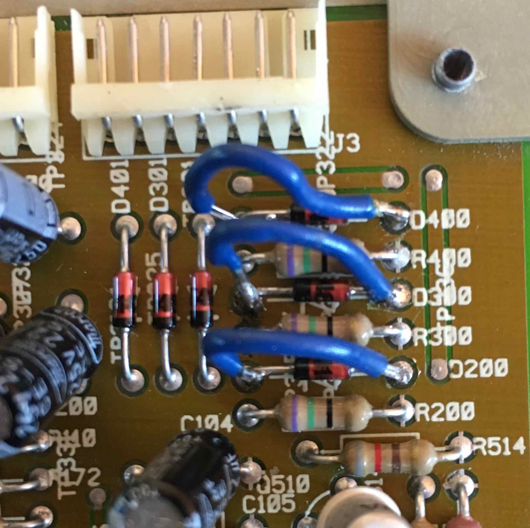

Posted: Fri Feb 16, 2018 10:36 pm    Post subject: Moome card requires PJ mods to work with 1209 (versus s)
I believe I have solved the diminished input problem:
- The 1209S uses R762719, for RGB switching board, which is what the Moome card seemed to be designed to. The inputs RGB go directly to a DC blocking capacitor so it doesn't matter if there is a DC component.
- The 1209 (Like an 808) uses R7617481 and its input is slightly different in that it has a high speed diode in series with the DC blocking cap. The problem is that the junction voltage of a forward biased diode is ~.7V which is what the incoming signal is roughly. So the diode is not only in its non-linear range but mostly shut off. I suspect the diode is to reduce ringing from undershoot but the 1209S didn't't seem to need it so I shorted all 3 RGB diodes and suddenly I had a much brighter picture.
This clearly explains why the Port 3 card worked fine with a 2.5V DC bias pushing the signal well into the diode liner on range.
Additionally, the Gamma changes are visible on the screen now.
It is too bright to adequately evaluate the results until tonight but I am pretty sure I have found the problem and I think also the solution. If it is not a good solution like this I have ordered a video opamp which I will wire up to add in the DC offset needed.
This is the RGB switcher in the 1209S - no diode before the DC blocking cap.
This the board in the 1209 - note the diode BEFORE the DC blocking cap.
These are the jumpers over the input diodes.
 Filename:  IMG_6850.jpg
 Filesize:  154.16 KB
 Downloaded:  653 Time(s)
