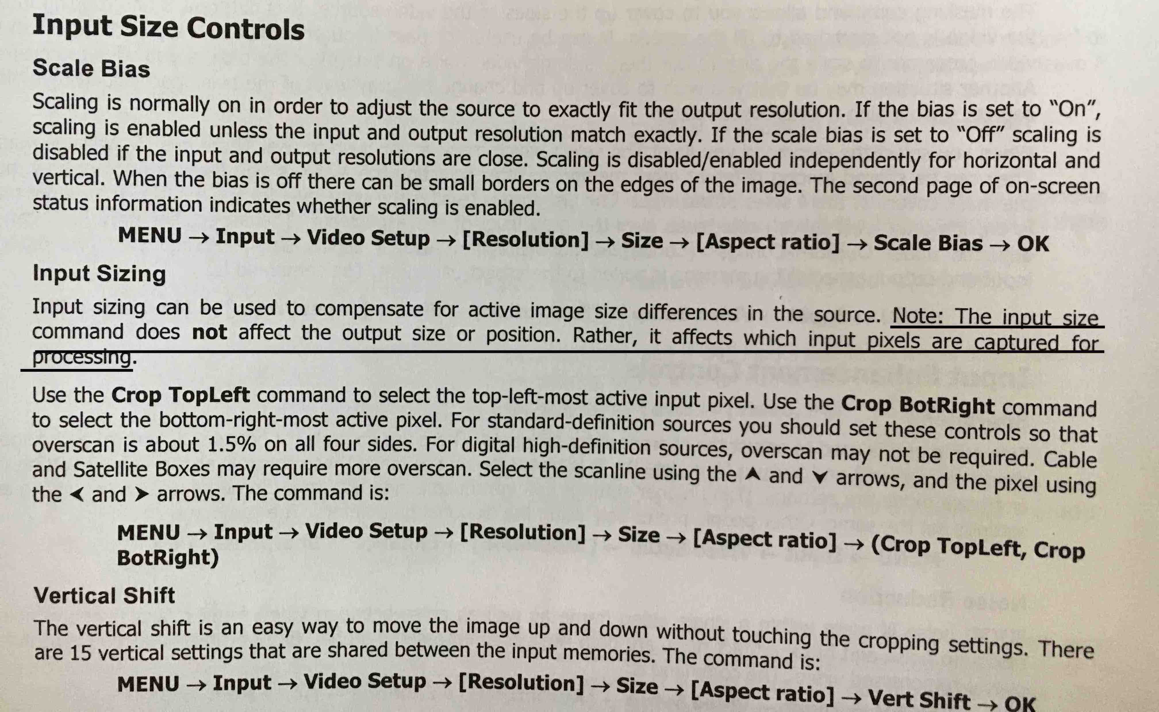

I have to respectfully disagree here. There is nothing to change Horizontal position or size. See photo from Page 25 of the manual (rev 11/24/09) Yes, for input size ratio, masking and NLS.... no for Horizontal positioning or size. See underlined statement.
I did find that the setting for image was 1080p50 (PAL) and the image reshifted closer to central when I changed that to 1080p60. Perhaps that was a projector setting saved (1080p50) that I was unaware of.
Note underlines

Sometimes shifting can happen on analog displays if the porches are too small. I believe the Radiance has a full set of controls to adjust porch sizes.
I guess I'm confused as to what's mean by "size" because that's only something that makes sense in the actual display that converts the # of pixels (+ left/right/top/bottom porches) into a physical picture. Before that all you have is a number of pixels and pixels don't have 'size'.

Did you reset the unit to factory defaults before starting.
All image sizing can be done under the output resolutions menu. As Kal says, there is full access to all the timings. The system is far superior to the old vision line.
