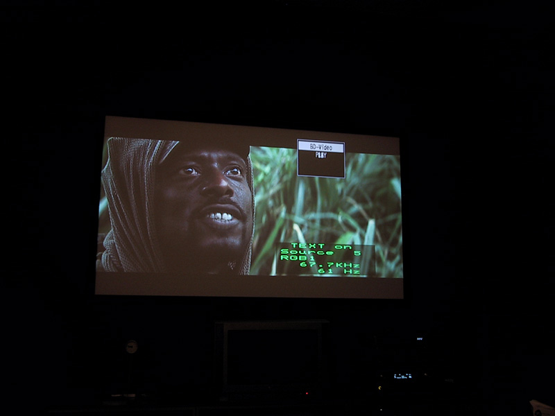

Put them all together, and what do you get? Yep! Perfect 1080p60, directly from the Bluray player connected to the 1209s, through a Moome with a reprogrammed EDID utilizing a custom made 1209s timing... no more need for soldering eeproms... or buying a scaler!

Did you have a light on in your room when you took that screen shot?
yes, behind the camera.

Damn... after some critical viewing i noticed that there is still some picture missing on the left... back to the drawing board...
Why is there so little info on EDID...

just curious, what size screen are you using?

96" wide 16:9, from Carada.
